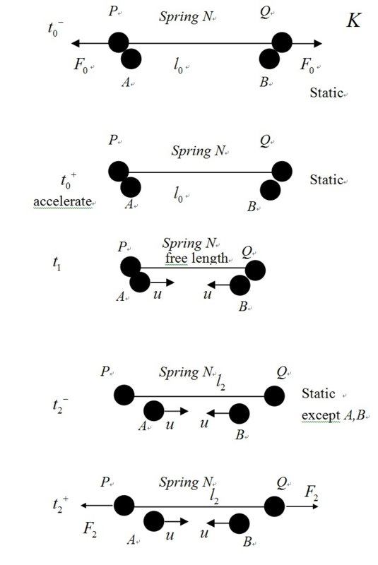

## \ \ \ \ \ ##In ##K##,System ##M## is composed of a spring ## N ## and four particles ## P, Q, A and B ##. The ends of spring ## N ## are fixedly connected with particles ## P and Q ## respectively. Particle ## A ## is adjacent to particle ## P ##, and particle ## B ## is adjacent to particle ## Q ##.
## \ \ \ \ \ ##Before ## t_0 ## , the spring is in tensile state under the action of force ## F_0## (##x ## direction)at both ends, and the spring ## N ## is static, with length ## l_0##.
## \ \ \ \ \ ##At ## t_0##, the force ## F_0## at both ends of the spring is removed, particle ## P ## moves with particle ## A ##, and particle ## Q ## moves with particle ## B ##. At ## t_1 ##, when the spring is in free length, particle ## A ## and particle ## P ## begin to separate, and particle ## B ## and particle ## Q ## begin to separate. Particle ## A ## and particle ## B ## move at velocity ## u## and ## -u## respectively. After that, spring ## N ## and particle ## P and Q ## vibrate freely.
## \ \ \ \ \ ##At ## t_2 ##, when the spring is at the maximum extension length, apply force ## F_2## at both ends of the spring to make spring ## N ## and particle ## P and Q ## rest again, spring length ## l_2##.
## \ \ \ \ \ ## ## l_2< l_0##,## F_2< F_0##.
## \ \ \ \ \ ##Before ## t_0 ##, the energy of spring ## N ## and particle ## P and Q ##is ## m_2c^2 ##+## m_1c^2 ##, and the rest mass of particle ## A ## and particle ## B ## is ## m_3 ## respectively. Spring ## N ## and particle ## P and Q ## lose energy ## m_1c^2 ##which is converted into the increased kinetic energy of particle ## A ## and particle ## B ##.
## \ \ \ \ \ ##After ## t_2 ##, the energy of particle ## A ## and particle ## B ## is ## 2m_3c^2 ##+## m_1c^2 ##, and the energy of spring ## N ## and particle ## P and Q ## is ## m_2c^2##. Here ## 2m_3c^2 ##+## m_1c^2 ####=\frac {2m_3c^2} {\sqrt {1-\frac {u^2} {c^2}} } ##, get ##\frac {m_3} {\sqrt {1-\frac {u^2} {c^2}} } ##=## {m_3} +\frac { m_1} 2 ##

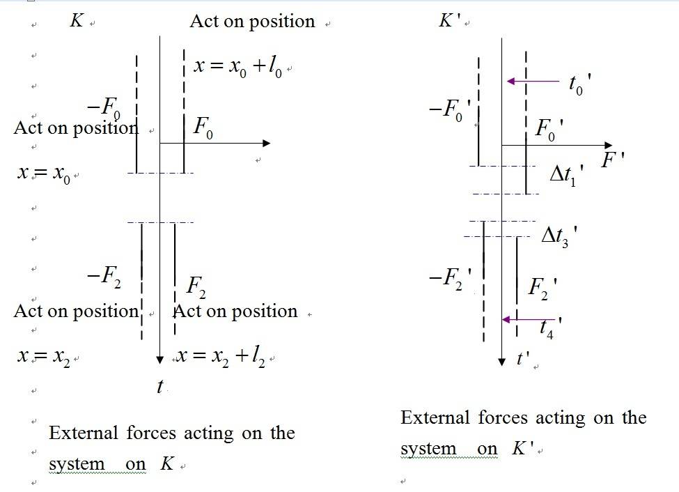

## \ \ \ \ \ ##The inertial reference frame ##K’## moves at velocity ##v##(##v>0##) on the ##x##direction relative to ##K##.
## \ \ \ \ \ ##In ##K’##, the external force of the system is as shown in the figure, ##{F_0}’ { \Delta t_1}’####-{F_2}’ {\Delta t_3}’##>0. At ##{t_0}’ ##,##{t_4}’ ##, the momentum of the system (##x' ## direction) is different.

From ## l_2< l_0##,## F_2< F_0##, can get ##{F_0}’> {F_2}’ ,{ \Delta t_1}’>{\Delta t_3}’##.

In fact, the different results of this momentum calculation are entirely due to the relativity of the same time.
I think so. But I'm afraid I made a mistake.
The four momentum is the same before and after in the unprimed frame, so it must be the same before and after in all frames.
## \ \ \ \ \ ##Because
## \ \ \ \ \ ####{ \Delta t_1}’= \frac { \frac {v l_0} {c^2}} {\sqrt {1- \frac {v^2}{c^2}}}##
## \ \ \ \ \ ####{ \Delta t_3}’= \frac { \frac {v l_2} {c^2}} {\sqrt {1- \frac {v^2}{c^2}}}##
## \ \ \ \ \ ##From ## l_2< l_0##, can get ##{ \Delta t_1}’ >{\Delta t_3}’ ##.
## \ \ \ \ \ ##And ## F_2< F_0##
## \ \ \ \ \ ##So ##{F_0}’ { \Delta t_1}’####-{F_2}’ {\Delta t_3}’##>0.
## \ \ \ \ \ ##At ##{t_0}’ ##,##{t_4}’ ##, the momentum of the system (##x' ## direction) is different.

By the following way, it can be obtained that its momentum is not the same at two times
Sure, that is during the time that the external forces on the system are changing in a spacelike fashion. That doesn’t change the fact that after the spacelike changes in external forces are complete the four-momentum is the same.
Also, ##F\Delta t## is not the change in the spatial component of the four momentum.

I get a general idea of what you mean. It can be concluded simply,
## \ \ \ \ \ ##At ##{t_0}’ ##,##{t_4}’ ## in ##K’##, the momentum of the system (##x' ## direction) is the same. This is a conclusion, called Conclusion 1.
But how to explain the following conclusion, called Conclusion 2? From ##{t_0}’ ##,##{t_4}’ ## in ##K’##, the accumulation of external force ##F## over time is not equal to 0, ##\int_{{t_0}’}^{{t_4}’} F’ t’~dt ’## ##={F_0}’ { \Delta t_1}’####-{F_2}’ {\Delta t_3}’##>0. At ##{t_0}’ ##,##{t_4}’ ## in ##K’##, the momentum of the system (##x' ## direction) is different.
There was a writing error in the last post. Correct as follows,
From ##{t_0}’ ##,##{t_4}’ ## in ##K’##, the accumulation of external force ##F'## over time is not equal to 0, ##\int_{{t_0}’}^{{t_4}’} F’(t’) ~dt ’## ##={F_0}’ { \Delta t_1}’####-{F_2}’ {\Delta t_3}’##>0.
Conclusion 2, At ##{t_0}’ ##,##{t_4}’ ## in ##K’##, the momentum of the system (##x' ## direction) is different.
Conclusion 2 contradicts Conclusion 1.

liuxinhua said:
the accumulation of external force F′ over time is not equal to 0
In relativity ##F \Delta t## is not equal to the change in momentum. The change in four momentum is given by the integral of the four force with respect to proper time.
The short version is that the Original Poster's handling of springs in special relativity isn't going to work for rather fundamental reasons. I did my best to point out some methods that might work, but they're probably too advanced. I hope what the OP takes away from this thread is that they don't yet know yet how to properly formulate springs and/or elastic media in the context of SR. I hope they focus on what they do have the background for, namely point particles, learn about those, and save the more advanced topics for a later date.
