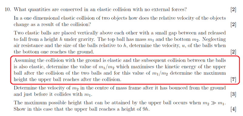

How do I calculate part d?
I know that (m2-m1)v0 = m2v2+m1v1
where v0 = root (2gh), v1 and v2 are the new velocity of the masses
(m2+m1)v02 = m2v22 + m1v12
I also know that v2-v1=2v0
but how do I separate the KE of mass 2?
It's ##m_1## that is the upper ball. Can you solve the equations to find ##v_1##?
Likes Clara Chung
I got a very strange answer...
v2-v1=2v0 ...(1)
(m2-m1)v0 = m2v2+m1v1...(2)
After substitution I get -v0=v1...
