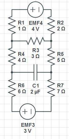

For the multi-loop circuit as shown, assuming the capacitor is initially uncharged, find the currents in each of the resistors at t=0 after the switches are closed.

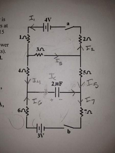

So I believe there are 8 unknowns really because of the 8th branch with the capacitor. If you look at the attached diagram 1, You can see what I mean. The problem asks for the currents across each resistor so I will use I1-7 for the currents and R1-7 for the resistances. Icap is the current across the extra branch.
ƩV=0 loop rule
ƩI=0 junction rule
V=IR
Its a long process but I chose the directions I assumed the currents were moving in diagram 2.
The circuit has 4 junctions for which I have the following 4 equations.
I1=I3+I4
I3=I2+I5
Icap=I4+I6
I7=Icap+I5
Next, I used the loop rule. There are 6 possible loops, I wrote 4 equations, one for each of the three inner loops and one loop for the outside. Since capacitor is uncharged there is no resistance and current goes freely through it (correct?).
For the top loop, I took the current to be traveling counterclockwise and got:
ε4-I1R1-I3R3-I2R2=0
Middle loop (taken clockwise)
-I4R4+I5R5+I3R3=0
Lower loop (clockwise)
ε3-I6R6-I7R7=0
Finally I went clockwise around the outside of the circuit
ε3-I6R6+I4R4+I1R14+I2R2-I5R5-I7R7=0
I haven't even found a single example approaching this kind of complexity. I'm trying to keep from curling up in the fetal position and crying.
I am not sure about the directions of my currents, so I'm worried that there are problems in my equations above. Is this possible? I've been told it just comes out negative in the end. Its asking a lot I know, but can anybody tell if all these equations are right?
I haven't taken linear algebra, but I've been trying to make it into a matrix and I have no idea what I am doing there either. It seems pretty insurmountable with algebraic methods, but that's not really what I'm focused on right meow. I think I just want to know that what I'm doing so far is right, then I can worry about getting solutions to I1-7. You are absolute lifesavers. Thank you.

physninj said:
1. Since capacitor is uncharged there is no resistance and current goes freely through it (correct?).
Right. Making the voltage across it how much?
The rest is not that bad. The current thru R6 & R7 is easy. Then, you can combine 3 resistors, put eh result in series with two other resistors, and you're done. You don't need to solve any KCL equations, just combine resistances in parallel & series etc.
hi physninj! :smile:
physninj said:
So I believe there are 8 unknowns …
no, I1 = I2, and I6 = I7 :wink:
… I chose the directions I assumed the currents were moving in diagram 2.
it doesn't matter what directions you choose
if you choose "wrong", the result for that current just comes out negative!
the only advantage of guessing "right" is that it makes a mistake very slightly less likely
… There are 6 possible loops, I wrote 4 equations, one for each of the three inner loops and one loop for the outside.
no, there's only 3 independent loops, so you can only write 3 independent equations …
(your outside loop equation is the sum of the other three)
just choose whichever three loops look easiest :smile:

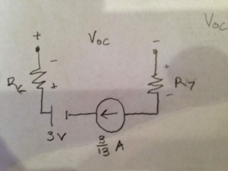

You've all been helpful, but I'm not sure where to go now. Ehild I studied up on Thevenin's theorem because it hasn't been covered in my class. Here is my latest work.
Starting with the lower loop I think I got I67!
ε3-I67R6-I67R6=0
ε3/(R6+R7)=I67
=3/13 A
I don't know what to do next, I drew what I think would be where I would try to apply the thevenin equivalent starting with the Voc for the open circuit. See attached for that. Now how to find the open circuit equivalent voltage, do I sum everything somehow?
Also, if there is a way to complete the problem without the Thevenin by continuing with KCL, I think it would be preferable. I'm not supposed to know how to use it, it's not in my book and not covered which I actually find peculiar. He might be impressed, but I don't want to risk his reaction on the exam.

Stop it with the fancy equations already! Look at the diagram. What by inspection is the current thru R6 and R7 at t=0?

You have a voltage source EMF3 in series with two resistors R6 and R7 so what's the current? What does it matter if there is a second voltage source? It has nothing to do with the current in R6 and R7!
Then use the same method for the other side of the circuit. There you'll have to do some parallel'ing and series'ing like (R4 + R5)||R3 etc. but the idea is the same.
The "shorted" C acts as as a wall between R1-R5 and R6, R7.
BTW there's nothing wrong with writing the KCL's. It's just a whole lot of extra work.

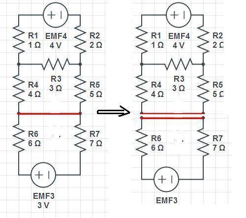

I got it with the KCL's. Yeah I don't agree with you. Whatever your method is, it's just giving me a headache. Just finding the effective resistance doesn't give you the voltage across the resistor, for R3 for example. You keep saying the fact that there are two batteries doesn't matter, It does matter, because it changes the potential and then I can't just divide it by the resistance to give current.
I12=16/21
I3=4/7
I45=4/21
I67=3/13
Thanks.
The solution is correct, good job! I haven't read the problem carefully, sorry. The Thevenin method was not a good idea. Rude man suggested to replace the capacitor with a short, a single wire as it has no resistance at the instant when the switches are closed. As the top circuit with the 4 V source shares a single wire with the lower circuit with the 3 V source, you can consider them as independent circuits.The currents can be obtained also by determining the equivalent resistances and applying Ohm's Law, but the KCL-s are also proper.
ehild
ehild
YES! Thank you so much! I see now that the current through the capacitor's branch is just I45+I67 and they otherwise behave like normal independant circuits. It could potentially be easier to solve that way. I'll give it a go, the first time was just practice. Thank you everyone.
