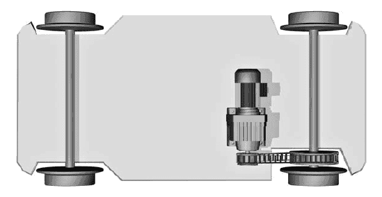

I have to design similar bogie to one shown above. It's is used on straight rail.
I am not sure what kind of construction I should use to connect body to axles.
More simple solution - better.
Additional information:
This bogie (including it self) has to be able to carry 4 tons.
Chain gear runs one axle (sprocket).
Motor is 0,75kW.
Bearings with pillow block casings...
Unless you need suspension. Then use a suspension system of your choosing.

What is your mechanical design experience? What calculations will you do to determine your safety factors? What are you planning to use for brakes? What is the maximum incline that this rail vehicle will see?
Thank you. It's exactly what I was looking for.

I study mechanical engineering, mostly directed to metal parts manufacturing. So I got this task for homework and was looking for simple solution.
About calculation it is not required to be very accurate in comparison to the drawing I am making. Just basic model how it might look. I think what Travis_King suggested is suitable solution for me.
Thank you for reply.
What I gave you was very basic. What type of bearing is suitable? What sorts of loads will the components see? Is suspension necessary? How will you keep the wheels aligned and the body centered?
