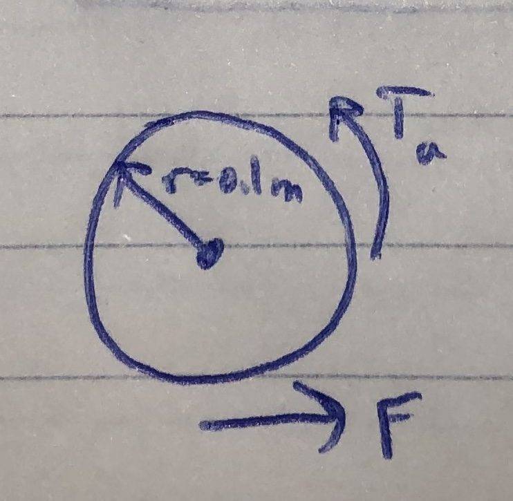

Hi everyone,
I'm working on designing a vehicle that uses electric motors, but I'm having a little trouble finding the load and acceleration torques in order to select the right motors to use.
Variables:
m = total mass of vehicle
a = acceleration
μ_r = rolling friction coefficient
r = wheel radius
N = normal force (vehicle weight)
J = moment of inertia
F_r = rolling friction
T_L = load torque
T_a = acceleration torque
α = angular acceleration
Assumptions:
  • m = 50 kg (distributed evenly across 4 wheels)
  • a = 2 m/s^2
  • μ_r = 0.02
  • r = 0.1 m
  • Vehicle driven by two back wheels using two separate electric motors (direct drive)
  • Driving on a flat surface
Calculations:
Here's what I've calculated so far. If I've made any mistakes or left anything out, please correct me.
Load torque:
  • F_r = μ_r * N
  • N = 50 kg * 9.81 m/s^2 = 490.5 N
  • F_r = 0.02 * 490.5 N = 9.81 N
  • T_L = F_r * r
  • T_L = 9.81 N * 0.1 m = 0.981 Nm
Acceleration torque:
I tried calculating this in two ways and got two different answers.
1. First I used a free body diagram, attached below.
  • F = ma = 50 kg * 2 m/s^2 = 100 N
  • 2 Driving wheels --> 2T = Fd = 100 N*0.1 m = 10 Nm
  • T = 5 Nm (per driving wheel)
2. Here's where I'm getting confused.
  • T_a = J*α ------- for one wheel
  • α = a/r = 2/0.1 = 20 rad/s
  • J = 0.5*m*r^2 = 0.5*25*0.1^2 = 0.125 kg*m^2--------------- I used 25 kg here since there are two driving wheels --> each one will accelerate half of the mass, if that makes sense. Is this assumption correct?
  • T_a = J*α = 0.125*20 = 2.5 = 1/2 the T_a I previously calculated. What am I doing wrong here?
Any help is appreciated. Thanks :)
hello @chessguy103 ,
:welcome: !
You are doing quite well. A clear list of variables and parameters. Working posted and good to follow. An example for a lot of first posters !
A few improvements:
chessguy103 said:
free body diagram
You do calculations for the body of the vehicle and for the wheels. It is sensible to have two free body diagrams. The one for the body is almost trivial: two driving wheels each exert a forward force that causes the acceleration. Upward force from the four wheels compensates the weight ##mg##.
So simple it can be omitted: We don't worry about the vertical forces or the non-driving wheels (but add their friction force at the driving wheels).
This allows us to draw a better FBD for the driving wheels: Yours is a nice start, but it is incomplete. If I leave out the vertical forces (mg/4 up and mg/4 down):
There is only one driving torque and it has to provide the acceleration and compensation for the friction, from the driving wheel plus the non-driven wheel, hence ½ Fr.
You found F/2 = 50 N so the torque for acceleration is 5 N##\cdot##m per driving wheel.
The torque to overcome friction has to be added to this, so 0.98/2 N##\cdot##m per driving wheel.
The torque to make the wheels spin should also be added to this, but for that you need the mass of a wheel.
Inserting half the total mass in the moment of inertia is not right: you don't want the whole thing to spin :wink: !
With e.g. a wheel mass ##m_w = ## 1 kg you have ##I = {1\over 2} m_w\, r^2## kgm2 per wheel, so 0.02 kgm2 per driving wheel. With ##\alpha = a/r = ## 20 rad/s 2 ##\quad \tau = I\alpha## yields 0.2 N##\cdot##m per driving wheel. So a small correction.
The torque to overcome another type of friction: wind resistance, should still be added to this: depending on the speed to be reached it can be the main torque!Clear so far ?

I see. I should account for that as well then.
One other thing: let's assume a coefficient of static friction of μ_s = 0.72 (car tire on asphalt)
That would mean that static friction force for all 4 wheels, F_s = N * μ_s = 50 * 9,81 * 0.72 = 353.16 N
Which means that F_s for a single wheel would be 353.16 / 4 = 88.29 N. So the force at the driving wheels shouldn't exceed this value or else they'll slip. Or, since it's two driving wheels would we do 353.16 / 2?
I'm thinking its the first one since the actual weight/normal force is distributed across all 4 wheels. But I'm not sure.
chessguy103 said:
μ_r = 0.02 is what I found for rolling friction coefficient between a car tire and asphalt.
And yes, I'm also adding mgsinθ*r for the extra torque needed for an incline. I just wanted to get the main calculations down first. I will also be adding a margin of safety. Thanks :)
One thing is the added resistance to rolling due to the continuos deformation of a rubber tire while rolling over asphalt; another thing is the "traction" or resistance to sliding or skidding of that same tire.
Please, see:
https://www.engineeringtoolbox.com/rolling-friction-resistance-d_1303.html
https://www.engineeringtoolbox.com/friction-coefficients-d_778.html
The second one is what determines how much tangential force your wheels can achieve during acceleration and braking, and its magnitude depends on the normal force and a higher value of static coeficient of friction, which is normally around 0.8 for rubber/dry asphalt.
Welcome to PF! :cool:
Likes chessguy103
I agree: the normal force per wheel is mg/4 and the maximum friction force is therefore ##\mu##mg/4 per wheel, diving or not.We had another thread on this where a difference between front wheel drive and rear wheel drive was discussed. It starts about hill climbing, but that turns into acceleration (physically more or less equivalent).##\ ##
Likes chessguy103
BvU said:
I agree: the normal force per wheel is mg/4 and the maximum friction force is therefore μmg/4 per wheel, diving or not.
Of course this assumes the mass of the cart is uniformly distributed! If not life only gets worse...but that is a good place to start.
