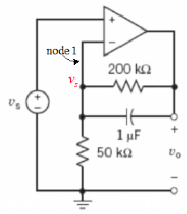

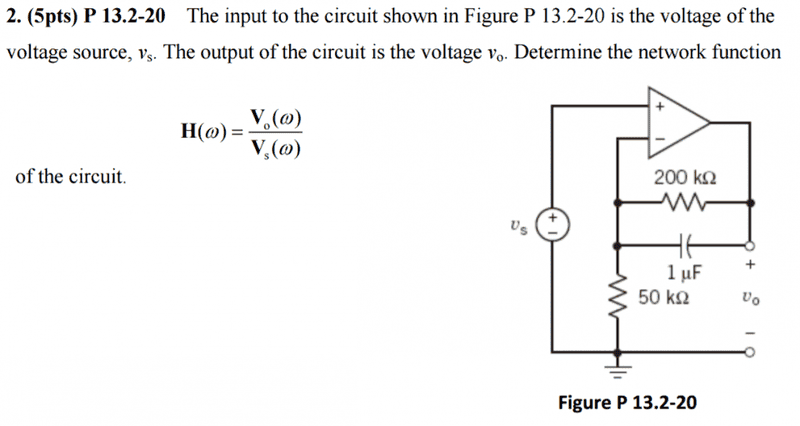

I'm really unsure of what to do. I feel like Vs should not be equal to Vo. I am not sure if I have the right idea with the equations that I have written. I am confused because I don't know the value for omega. Can someone help ? Thanks.
Write the node equation for node 1 (figure below) knowing that its potential is equal to that of the source voltage. Be careful with the impedance of the capacitor: What's the difference between the impedance formulas for a capacitor and an inductor?
Edit: By the way, the "network function", or "transfer function" is a function of ω, so it will remain as a variable in your result.
