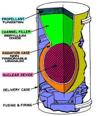

I've been doing some reading about Orion-drive spacecraft , but I don't understand the requirement of a high Z propellant like tungsten. Assuming that the pulse unit were detonated further away from the craft to prevent it from drilling a hole in the pusher plate due to its narrower angle, why couldn't the pulse units use a low Z propellant to gain a higher exhaust velocity? I assume there's a reason, but it isn't easily found information.

My question relates to Orion drives which do not require an ablative surface. I got the high z propellant requirement from http://www.projectrho.com/rocket/enginelist.php#orion", which I understand to be a fairly reputable site.
Specifically, I'm talking about the design of the nuclear shaped charge pulse units themselves:
Note the use of tungsten as propellant. This is the part I do not understand.
I have seen (over 50 years ago) either a tungsten or tantalum disk that had ≈1 mm of surface ablated by x-rays from a small (few kt) blast. I believe the recoil force (impulse) was measured. I think the reason for high Z is to maximize the momentum transfer (thrust) per unit x-ray energy. Recall p2=2ME

I firmly believe that this type of propulsion is unworkable, but if it could work, the only way is if there is a large thick tungsten shield between the nuclear device (a few kt or less) and the rocket body. The tungsten shield protects the rocket and its contents from the radiation. The x-rays from the detonation will heat up and ablate the tungsten surface. Recoiling material ablating from the tungsten surface will transfer a momentum impulse to the rocket. To get the maximum momentum impulse p·Δt from the available x-ray ablating energy, p2 = 2ME, showing that M should be maximized, where M represents the gram-molecular-weight of tungsten.
