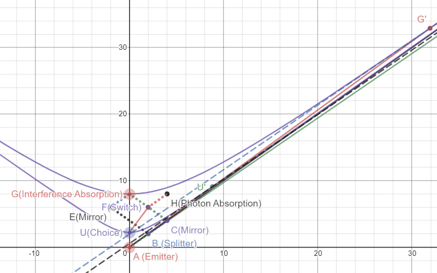

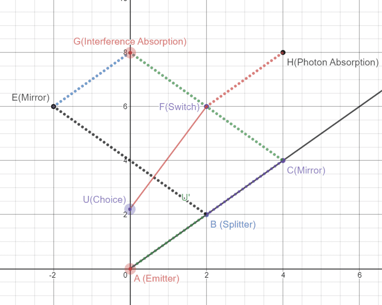

Thanks for your quick reply! I intend to study your response more thoroughly, but first, a possible clarification:
Isn't it valid to consider an idealized spacetime diagram (S) of this experiment like this:
And to imagine that Shimony's world line is the ct axis. Now we have a proper time for AG. Yes?

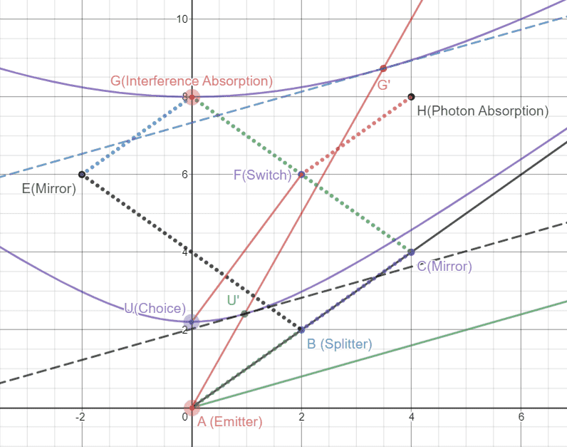

Then I'd like to measure AG in reference frames (S', S'', etc.) at successive velocities, moving to the right, to gain intuition about the limiting case. (I understand that in this experiment, the photon is zig-zagging, but each zig-zag would present a symmetric case +c, -c.) So, now plotting the spacetime invariant for each event, and plotting the tangent simultaneity lines for S'. I get this, for v=0.4c.
Moving to S'', at v=0.97c, the event simultaneity lines are getting closer and closer (on ct) suggesting the limiting case I tried to make previously. And further and further apart on ct'', suggesting slower and slower clock in S''.
I think I'm pretty far out on a limb here, looking for an intuition I like better than those on offer. I appreciate any further comments you think helpful. As you see, I've found the results of this experiment very puzzling.
Thanks
No, because you're purposely constructing the diagram so it's consistent with your claim, by making the "choice" and "splitter" events spacelike separated, so you can change their time ordering by changing frames. But you don't know that that's true of the actual experiment. The "choice" event could be anywhere in the past light cone of the "switch" event in your diagram, and there are plenty of events in the past light cone of the "switch" event that are also in the future light cone of the "splitter" event, not spacelike separated from it.
No, because I wouldn't purposely mislead you. And besides, my point isn't about the order of events. It's about all of these events, from emission to absorption, approaching simultaneity as measured from a series of reference frames where v is approaching c.
Limit theory is based on epsilon-delta arguments. Give me an epsilon, in this case an elapsed proper time between events. And I can give you a delta, in this case a velocity at which a relative reference frame would measure elapsed proper time within epsilon. So, in the limit, as epsilon approaches zero, delta approaches c.
As I'm sure you know, limit theory was originated by Newton and Leibnitz (and possibly even as early as Archimedes) specifically for use in Physics. Why not allow it here?
You apparently did not grasp my point. If the "choice" and "splitter" events are not spacelike separated, it is impossible for them to be simultaneous in any frame.
XilOnGlennSt said:
Limit theory
Has nothing whatever to do with the question at issue. All you need to know is whether the "choice" and "splitter" events are spacelike separarated or not. You don't need to take any limits anywhere.
As you drew the diagram, it is perfectly possible for them not to be, since the only requirement for where the "choice" event has to be placed on the diagram is that it has to be in the past light cone of the "switch" event, and there are plenty of events in the past light cone of the "switch" event that are not spacelike separated from the "splitter" event. So your placement of the "choice" event on your diagram is not justified by our knowledge of the experiment, and cannot be used to prove anything.
