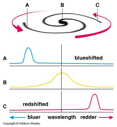

It's done by spectroscopic measurements. Any galaxy that is not aligned perfectly face-on, will exhibit rotational Doppler shift, with material on opposite edges having opposite shifts.
So you choose some benchmark line (e.g. Hydrogen alpha emission lines), and then compare this benchmark with Doppler shift of lines observed at some radius R from the centre. This gives you radial velocity. To get orbital velocity you need to additionally compensate for the inclination of the galactic disc (if any).

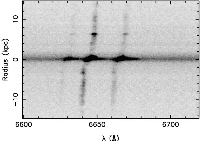

Here you can see an example measurement of H-alpha lines of a galaxy seen almost edge-on (UGC 2936):
The galaxy is approx. 150 million light-years distant, and yet the Doppler shift is clearly visible, netting a pretty flat rotation curve of approx. 225 km/s.

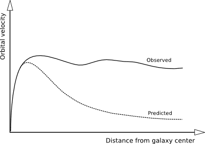

You get this sort of discrepancy:
In order to maintain such flat curve, you need a lot of extra matter. Its total mass must grow linearly with radius from the galactic centre, and extend quite a bit past luminous (stellar) regions - this is because the rotation curves of hydrogen clouds orbiting beyond the galactic fringes are also measurable, and these retain the characteristic constant orbital velocity. The total amount of extra mass exceeds the visible mass by a factor of 5, so you know that's a major problem.
Measurement error is out of the question - these curves are way too common, and error bars are low.
