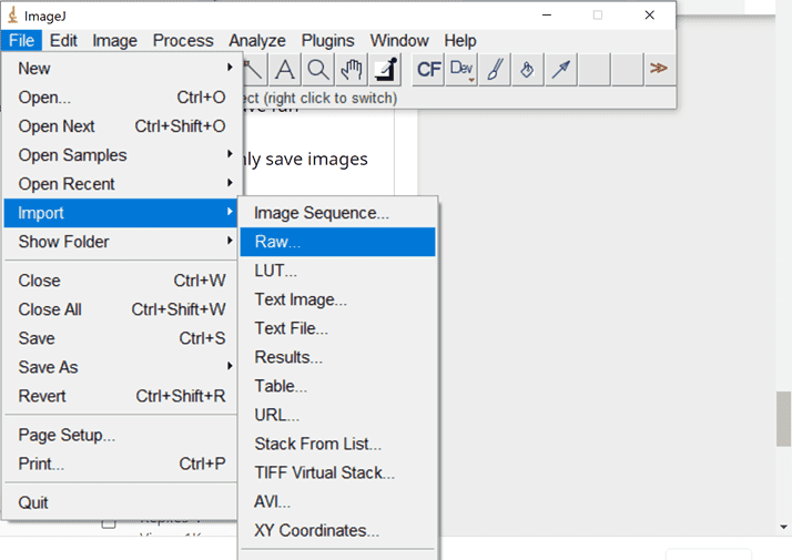

I may need one more piece of advice: assuming same illumination, etc. I am take two images of the two similar objects with a digital camera and would to compare the image brightness (mean intensity, integrated intensity, easy to get in ImageJ) in the same ROIs. I can do that.
But before I do the comparison analysis, so the comparison is fair, should I convert the two images from jpg to some other format inside ImageJ? For example, should I first convert both two images to 8-bit before comparing them (Image-> Type-> 8-bit> save)?
Thanks
It would be better if you could get a non compressed raw bitmap image from your camera (bmp). If jpeg you want the least compression possible and you might want to compare some images at different compression. I do not know exactly what jpeg does. For manipulation just keep it bmp until you are finished. Have fun
Likes fog37
Thanks!
I will borrow the camera tomorrow (a Canon ). Based on the camera instruction manual, I believe it can only save images either as jpeg or RAW. I guess I would save them as RAW and then import them into ImageJ. Instead of using Open..., I will import them using Import -> Raw..., unless I am making some mistake doing that...
