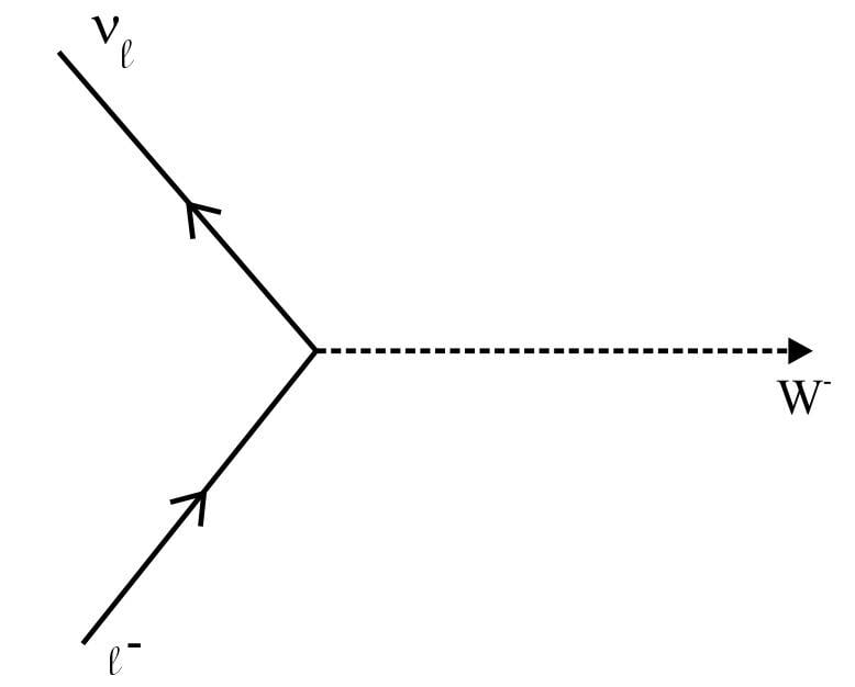

I have found in the book "Introduction to elementary particles" by David Griffiths the description of a characteristic process of the weak interaction. i.e.:
where ## {\cal l}^- ## represents either an electron, a muon or a tau. The bosons ##W^-##, ##W^+## and ##Z^0## are the mediators of this interaction.

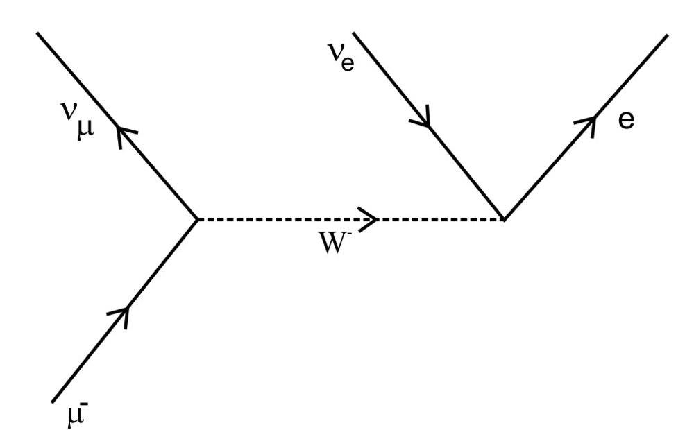

Another process which he has called one of the cleanest of all weak phenomena is the muon decay, shown bellow. This process can be represented by $$\mu \rightarrow e + \nu_\mu + \bar \nu_e $$.
