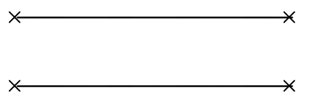

If I have a Lagrangian of the form
[tex]\mathcal{L}=-\frac{1}{2} (\partial \phi)^2 - \frac{1}{2} m^2 \phi^2 - \frac{\lambda}{3!} \phi^6, [/tex]
in 3 dimensions, what is the one-loop correction to the 4-point function? Am I correct in thinking that the following Feynman diagram is the representation of the 4 point function for this Lagrangian?
242549

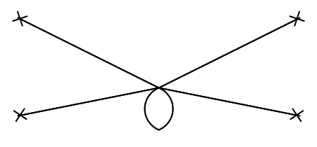

The only one-loop diagram I can think of is
242550
however I'm struggling to see how this is explicitly a correction to the 4 point function I drew above.
It's a bit unusual to consider disconnected diagrams (the first one you've drawn). For the connected diagrams the 2nd diagram is the leading-order contribution to the four-point function.
Since you Lagrangian has no ##\phi^4## term, at this point you'd have to introduce one, because this loop is (in 3D linearly) divergent and thus you need a ##\phi^4##-term in the Lagrangian to renormalize it.

Hi, this was an question from a problem set where there was no [itex] \phi^4 [/itex] term. The question later asks whether the theory is renormalizable or not. When talking about one-loop order corrections, are the corrections always to the connected diagrams and not the disconnected ones?
For renormalization you only need to consider the even smaller subset of the one-particle irreducible connected amputated diagrams (the proper vertex functions).

Thank you for your help. Can you tell me if this is correct or not. Is the one loop diagram I drew above finite since
[tex]\int \frac{d^d k}{(2\pi)^d} \frac{1}{k^2 +m^2 -\imath \epsilon} \propto \Gamma\left(1-\frac{d}{2}\right) [/tex]
is finite for [itex] d=3[/itex]?
Edit: I just re-read your reply above saying that this integral should be linearly divergent so I don't know where I've gone wrong.
Let's calculate the Euclidean (Wick rotated) integral. Then with a cut-off ##|k|<\Lambda##
$$\int_{K_{\Lambda}} \frac{\mathrm{d}^3 k}{(2 \pi)^3}\frac{1}{k^2+m^2} = \frac{1}{2 \pi^2}\int_0^{\Lambda} \mathrm{d} k \frac{k^2}{k^2+m^2} = \Lambda - m \arctan(\Lambda/m),$$
and this diverges linearly with the cutoff as expected.
