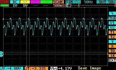

I am a little confused about the voltage stability. I understand why they rails fluctuate. But do the cap's across the resistors not help smooth that out?
I attached a little (cheap and portable) Oscope across the + and neutral rails without the 47uF Caps across the resistors in the voltage divider:
With the caps
