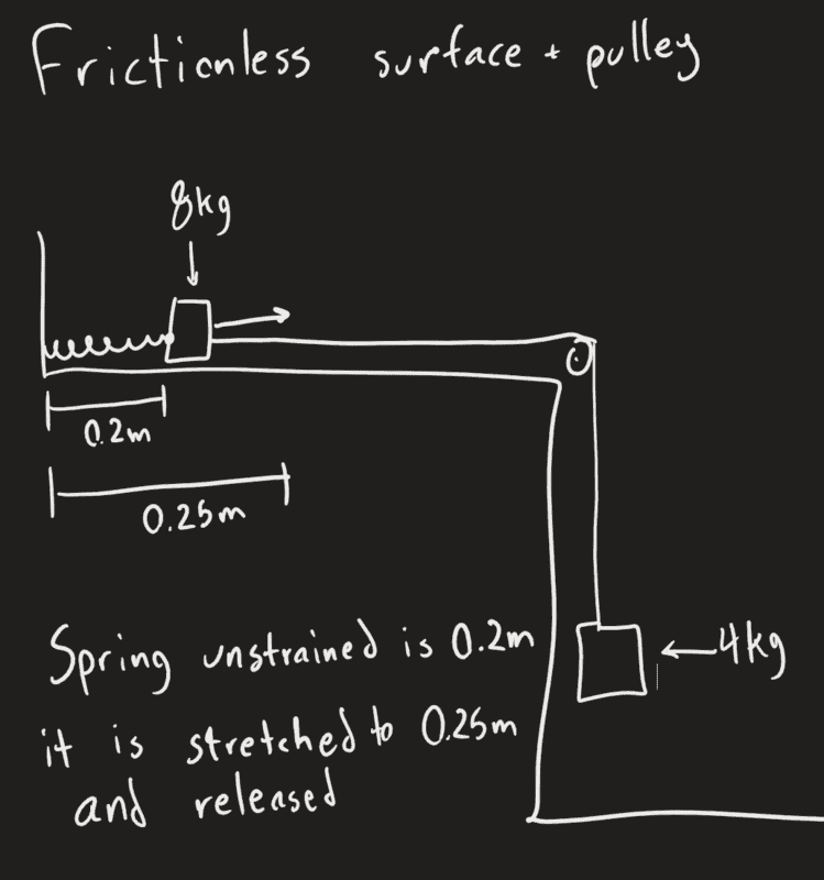

Oscillating Spring Problem With a Pulley. Need Answer by 3/3/20 please help.
w=sqrt(k/m)
f=ma
Us=1/2kx^2
1. Draw Free body Diagram for each weight.
2. Solve for Tension in Rope.
3. Find Spring Constant.
4. Find omega (w, or angular velocity)

There is not enough information. E.g. consider spring constant =0; it does not contradict any given info.
Need to know the equilibrium length of the spring as well as the relaxed length. Or maybe 0.2m is supposed to be the equilibrium extension of the spring?
I was about to edit my post and add that we need the full statement of the problem. The 0.2 m, a.k.a. the unstrained length, must be the no load length.
the spring at equilibrium is 0.2 meters
I was careful to write "equilibrium extension", i.e the extension at equilibrium. Knowing only the equilibrium length, but not the relaxed length, doesn't help.
sorry, I am not very good at physics, the equilibrium extension is 0.2 meters

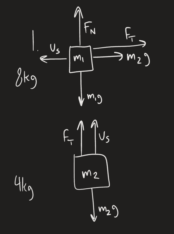

here is the free body diagrams, I am working on the rest
You should only consider forces acting directly on a body. Mass m1 doesn’t 'know' anything about m2g, just the tension. Similarly m2.

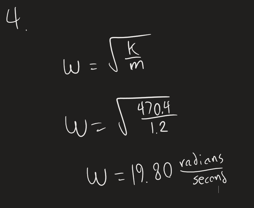

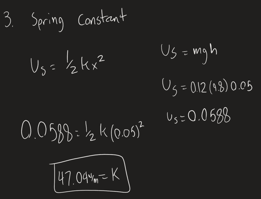

I tried my best, but I am not sure how to work around finding tension with the spring involved
here are the last two parts. Thank you for helping me!

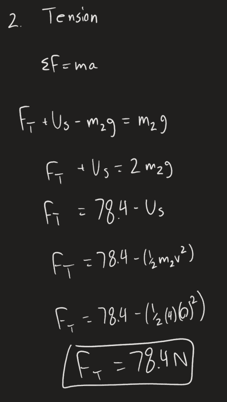

I tried part two again based on you advice and I think I did it correctly.
Fnet=ma
T-mg=mg
T=2mg
T=2(.4)(9.8)
T=7.84 N

I just realized I messed up my units on #3 by a power of 10. It should be .588 rather than .0588 and 470.4 rather than 47.4
jschim said:
T-mg=mg
I assume this is for m2.
How many forces act on m2 and what are they?
weight acts downwards, and tension acts upwards
Right, so what equation does that give for balance?
netF=tension-weight
right??
jschim said:
netF=tension-weight
right??
Right, this is the net force on the hanging mass. What is it equal to?
It would be equal to the hanging mass times acceleration, in this case, gravity.
f=ma
Correct. Can you write another equation expressing Newton's 2nd law using the free body diagram of the mass attached to the spring? Do that using symbols, not numbers. Also to distinguish the masses from each other use m1 for the mass on the table and m2 for the hanging mass. Once you have written the second equation, put them on two separate lines, one below the other.
Yes.
It is not accelerating. It is stationary until the spring is released.
kuruman said:
Correct
No, what @jschim wrote in post #20 goes wrong at the end. I suspect this is how he or she got the erroneous T-mg=mg in post #13.
Yes, of course. I guess I stopped reading after "mass times acceleration".
