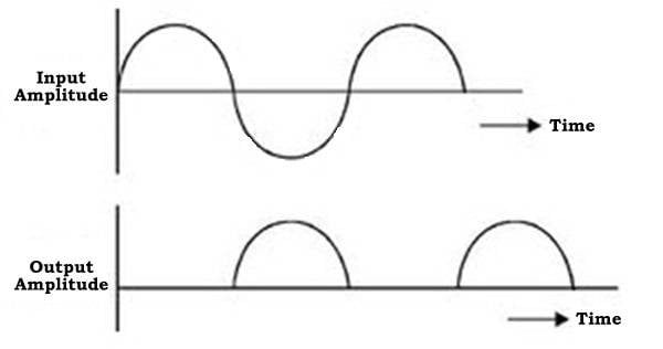

well it's a pulsed AC ... have you looked online to see what the waveform looks like ?
the top is the full AC voltage on the secondary side of the transformer
the lower is the half wave rectified voltage across the load resistor after the diode
half-wave rectification in general uses larger value smoothing capacitors to help keep the voltage from sagging (dropping) so much between each pulse.

thanks for correcting me... m new at this so i mixed up all the terms... i know that the graph of the half wave rectifier looks that way... but my point is the diode less wire of the secondary will conduct current no matter what happens... so why didnt the graph consider thqt
no it doesn't, there is only current flowing in one direction, and that is the 1/2 cycle when the diode is conducting
NO current is flowing during the other 1/2 cycle

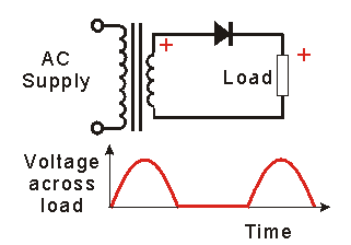

This is the circuit we're talking about.
So what is your exact question here?

lets consider the wire connected to diode A and the wire connected to the load resistor B. When forward bias occurs then current flows through A and B. A due to the diode has an output current in the form of pulses. But B has no diode therefore the current would be ac through it. Both of them will pass through the load transistor. I am saying that the output would be quite messy then

no, you are still not quite understanding :smile:
look at cnh1995's circuit ...
and what I said in my previous post
during the positive 1/2 cycle, when the diode conducts, it ONLY CONDUCTS in one direction ( we will use conventional current flow), in the above circuit that is out of the top of the transformer secondary, where the red + is through the diode, through the load resistor through the bottom wire and back into the transformer
during the other 1/2 cycle (the negative 1/2) there is no conduction, the diode door is shut
so current cannot flow into the bottom wire through the resistor and up to the diode.
there has to be a complete circuit path for the current to flow
so again repeating what I said earlier, the load resistor ONLY sees current flowing through it in one direction
and it see only pulses of voltage as the diode conducts for each positive 1/2 cycleDave
