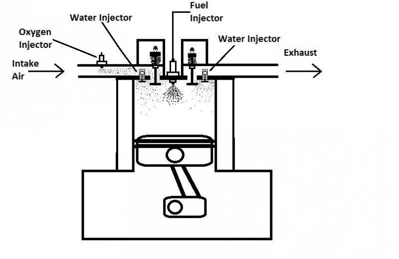

Hello PF members and guests,
I have been working on this concept for 2 years and I wanted to get some input from this forum. I have done a lot of research on oxygen enriched combustion and water injection. Both of these concepts have been tested and proven in experiments and the real world. My idea is to combine the two since both of their qualities would work together and enhance each other. I also realized in my research that the idea could be used to make a new type of internal combustion engine.
The basic idea works like this:
For a compression ignition engine (diesel)
1. Air is pulled into the engine, this intake air is enriched with oxygen up to the desired level (raising the O2 content in the air from 22% ambient up to 23-24% or higher like 30% or more)
2. The intake air enters the cylinder through the intake valve, the valve closes and the mixture is compressed
3. Around TDC the fuel oil is injected and combustion is initiated, driving the piston down on the power stroke
4. About half way through the power stroke the fuel oil will nearly be completely combusted because of the much faster burn rate due to the oxygen enriched air. It is at this point that a high pressure injector injects water as a fine mist spray directly into the cylinder. The water injectors are built into the cylinder head in the spaces between the intake and exhaust valves. The water has been preheated to 200-210* Fahrenheit by a heat exchanger in the exhaust manifold; this heated water is stored in a insulated tank on-board the vehicle
5. When the heated water is injected at high pressure directly into the cylinder it flash vaporizes into steam; the expansion energy continues to push the piston down to complete the power stroke. By the time the piston reaches BDC the steam has absorbed much of the thermal energy and turned into dry steam at temperatures from 500*-2000* Fahrenheit
6. The exhaust valve is opened, the piston rises and pushes out the remaining gases. As the gases leave the cylinder they pass through the heat exchanger and transfer some of the remaining thermal energy to preheat the injection water
7. Optional: A turbocharger is used to collect the remaining energy from the exhaust gases. I'm not sure how this turbocharger would be designed since it would be running on two gases; steam and other gases (mainly CO2) I don't know if it would be a conventional turbocharger or more like a steam turbine, this is where I could use some advice
That's the basic idea. It's possible to modify a conventional four-stroke direct injected diesel engine into this design.

Your idea looks a lot like the six-stroke engines ... combined into 4 strokes.
Lately, Bruce Crower revived that idea but it sounds like it was abandoned. One of the big problem - I think - was the fact that the steam was washing away the needed thin oil film on the cylinder walls.
You might be able to contact him directly via his company and have a more attentive ear to your idea.
Modern internal combustion engines, as used in most present-day cars, are very efficient, burn the fuel completely, don't pollute much (thanks to computerized control/fuel injection and catalyzers) and need very little maintenance. There is no need (nor a market) for radically new engines... The present designs may be conventional, but have been (and are) continually improved by the automakers, reaching better and better efficiencies and lower and lower pollution levels.
Likes billy_joule
While modern engines have come a long way there is still much room to improve. Modern engines may have high efficiencies in the lab but in the real world they do not. I believe extended range electric vehicles are the solution and offer a way for us to progress to fully electric vehicles. The engine I have designed would make the most sense in an application like this. I am a professional semi truck driver and I can tell u the name of the game is fuel. Companies are willing to pay thousands of dollars for things that save fuel, even if it only increases the mpg by a few percent. The other big issue is emissions; we spend a lot of money on diesel particular filters and diesel exhaust fluid. My engine would require neither of those. It is not cheap to replace the diesel particulate filter when its no good. When combined with an electric drive train my engine could double or even triple the mpg that our trucks are currently getting 8 mpg max)
Yes my design does resemble the six stroke design but I think it has advantages; it makes better use of the thermal energy by utilizing it before it has a chance to soak into the engine block and cylinder heads. Also since the steam only pushes the piston for half of the stroke instead of a full stroke the oil film issue should be less of a problem, although it is a good point and definitely something I would need to take into consideration
Also, not only does my engine use less fuel, it can use cheaper fuel which makes it an even more attractive option for fleets.
I don't think you can necssarily assume that vegetable oil is cheaper, volume by volume, than diesel oil. It's also not clear how the energy content of a gallon of vegetable versus a gallon of diesel also compares, although I tend to think the latter has a higher heating value.
Yes that is true currently, but that may change eventually. The main point is that vegetable oil is a renewable fuel; unlike biodiesel which requires huge amounts of energy, methanol and sodium hydroxide to be produced. With new technologies like algae oil production coming into play it is possible to produce vegetable oils sustainability and eventually become price competitive with diesel. Also, lower grade petroleum based fuels like bunker oil could be used without the high emissions. Lastly, vegetable oil is much more environmentally friendly as it is non toxic and is carbon neutral. I know that Palm oil production destroys land but this is certainly not the only way to make vegetable oil.
Hydrocarbons typically need about 1.5 times their mass as oxygen to combust. If you want to increase the oxygen fraction in air by 2%, this means ~10% of your oxygen comes from an internal storage - which has to store 15% the mass of the fuel tank. While oxygen is cheaper than hydrocarbons, the storage will cost something and I don't see the infrastructure for the oxygen supply. Also, storing something flammable next to an oxygen tank is usually a problematic idea.

Burning bunker oil in regular diesel engines raises problems all its own. First, the bunker oil must be heated in order to pump it, typically to at least 200 F. Second, bunker oil contains all sorts of undesirable compounds which will deposit inside the engine. Third, without refining, bunker oil can potentially contain a relatively large amount of sulfur, which, after the bunker oil is burned, will deposit inside the engine and lead to corrosion of the metal parts of the engine and contamination of the lube oil.

9. The water that is injected into the engine needs to be free of dissolved solids that could leave deposits in the engine. This is accomplished by having a water filter that removes these impurities; or by using distilled water. The filter would need to be changed at certain intervals when the vehicle is serviced; if distilled water was always used the filter would never need to be changed, but for convenience and safety regular tap water could be used. The water would need to be refilled when the vehicle refuels
In colder climates, water can freeze when the air temperature is not above 0C. Unless you can provide a failsafe, so that breakdowns while in transit will not compromise the integrity of system components from frozen water, the engine might have difficulties being accepted above certain latitudes.
In high-powered aircraft piston engines, a mixture of methanol (as antifreeze) and water at 50% was sometimes injected into the cylinders for a short time, to give a power boost in combat situations...
Where does the electricity come from? The whole point is to generate the electricity from renewable sources like wind, solar, geothermal, ocean thermal etc. Even if you used petro fuels like natural gas the emissions would be less because of the higher efficiencies that combined cycle power plants can offer; also the emissions are localized and it is possible to scrub the exhaust gases or trap the carbon, things that are not possible to do on a vehicle because of weight and motion.
I have thought of many failsafes to protect the engine in cold weather. In the event of a break down the water tank can simply be drained. Any water in the lines or injectors can also be drained or pumped out,. When the vehicle is running fine and shut down for the night (commercial truck drivers are required to take a ten hour off duty break following eleven hours of driving) battery power or fuel is used (if an electrical outlet is not available) to keep the water at the correct temperature, or at least above freezing. The operator can select how power or fuel use if for example the vehicle was left and parked for a week unexpectedly, if the vehicle was not restarted in let's say 48 hours the vehicle would begin purging the water injection system. With an efficient insulated water tank (like a Dewar vessel) it actually takes very little energy to keep the liquid hot or above freezing. Methanol could be used but that would raise the operating cost and change how the water injection system works (because of the difference in vapor expansion between water and methanol. Remember, ice won't damage components unless it does not have room to expand. Ice only damages things when it doesn't have somewhere to expand to.

Hi Jordan,
Your idea is very interesting. This makes us shares the same belief in how a future combustion should be. The flame from the oxygen combustion is really hot and you need to cool the entire combustion volume ASAP the moment charge ignition starts. Failing to cool it will melt your piston. This necessitates you to inject heated water as the ignition occurs but not to the point where the injected water can compromise the flame propagation. Many papers have documented how the combustion quality is compromised and that's why I inject the water upward rather than downward. With the water injected upward, this gives me the opportunity to further stratify the oxygen and fuel inside the piston bowl. You can read all these details in SAE papers that i wrote years ago.
Chinese researchers are going big in oxygen combustion and they are very well funded by their government. You should review great works done so far by researchers from Tongji University.
