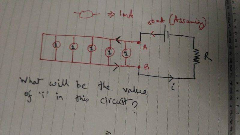

Assume I have a parallel circuit of current sources with 5 current sources generating 1mA each. Therefore from both the terminals I will get 5mA total. Now if I add a battery to one of the terminals where current(i) will flow into my circuit. If i = 50mA, will I get 55mA current from another terminal of my circuit??
How do you “add a battery” to “one terminal”. You need to draw a couple of circuit diagrams showing the sources with and without the battery. Are you going to be charging that battery or is it an arbitrary fixed voltage source.
I can see no way that your statement could be true. So my answer is probably No.
But produce your circuit diagrams, (drag and drop them onto the edt window), so we can work out exactly how you modify the circuit when you add the battery.
Actually by adding a battery I meant connecting the battery in a way that it is able to deliver the current to one terminal. However here is my proposed circuit.
Replace the five current sources by a single 5 mA current source in series with a battery and resistor.
What would be the value of 'i' then?
55mA. Isn't it?
If you have a single loop and you know the value of current through anyone component, isn't that the value of the current through out the circuit?
In this circuit the current source dictates the current. The voltage source would dictate the voltage level.
The ideal current source allows any voltage to be developed across it. The ideal battery allows any amount of current to flow through it.

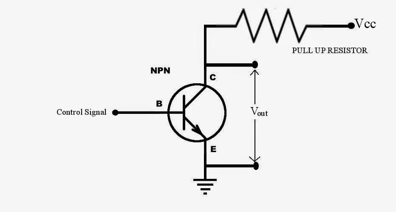

have you studied transistors yet? This is something that comes up in very basic transistor circuits. Transistors are examples of current sources. The current through a transistor is a function of its amplification factor, and the base current. Not the voltage tied to the collector of the transistor.
Take a basic transistor circuit:
This is quite similar to your circuit. You have a battery, Vcc, you have a resistor, and you have a current source. The current through the battery, resistor, and current source is affected only by the base current of the transistor. The voltage supply is a constant, and the current it delivers is a function of the current source. The current source is drawing current from the battery. They cannot be different..
If you have a circuit with no battery, you assume the current source is able to draw its current from an in-explicit source of energy that has been absorbed into the current source symbol.. but this is how I understand it..

both pts A and B will have 5mA current. Now when battery delivers 50mA current in pt A...
The battery can't deliver 50mA in pt A. It can't deliver more than the current sources are drawing.
