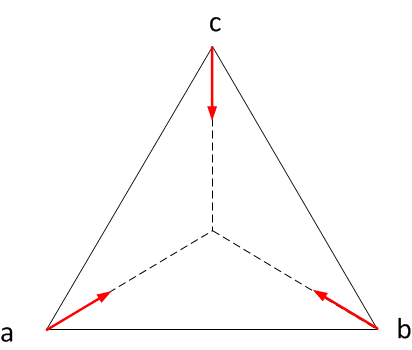

This the basic idea ? i.e. that e.g. a moves towards c with the same velocity as towards b (i.e. over the perpendicular in the middle of bc ?)
It should be clear that ##v_c \ne v_a - v_b##, so what is the meaning of the relevant equation ?
Where does the ##v\cos(60^\circ)## come in ?

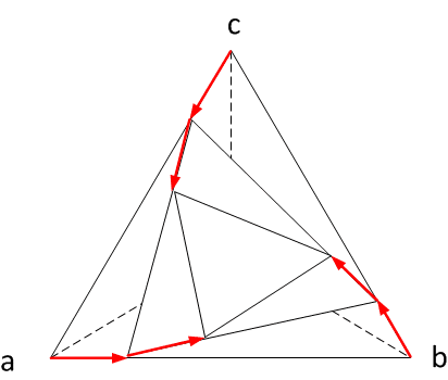

So each of the points moves along the edge of the triangle towards the next point.
This, point a moves towards point b which moves towards point c.
As they always move towards the next point with the same speed, they always form the vertices of an ever smaller equilateral triangle and converge at the Center.
D would be the length of the side of the initial equilateral triangle.
Ah, so we have a dog chasing hare(*) kind of thingy ! Like below ?

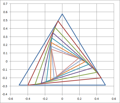

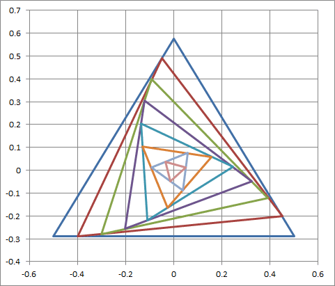

More or less by hand o0) .
a,b,c are x and y positions. point a is repeated to close the triangle ab bc ca
##\vec v_a = \left [ \left (\vec b_x -\vec a_x \over |\vec b -\vec a| \right ) |v| , \left (\vec b_y -\vec a_y \over |\vec b -\vec a| \right ) |v| \right ] ## etc.
and
##\vec a(t+\Delta t) = \vec a + \vec v_a \Delta t ##
