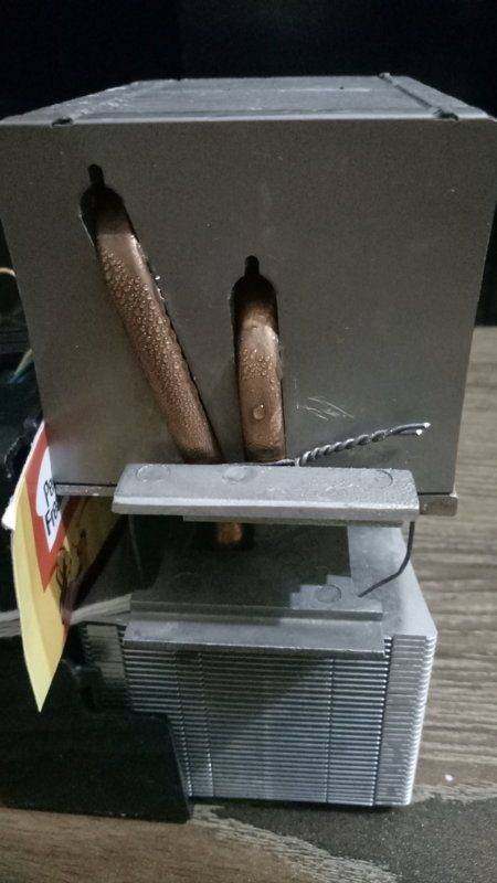

My current problem was why cold was not being transferred to cold side heatsink and I solved this problem.
My Findings.
My designed box is totally failure, that kind of box can work for small water cooler i.e. put one steel pot (insulated) on Pelier cold side with flat heatsink. But to get cold air flow this design will not work, there is no airflow space at cold side box. So I will redesign this box according to new findings and material size.
Cause of Cold Transfer Problem
1. Hot side fan was approximately 1-2 inches away from heat sink however it should be tied with heat sink. So in fact heat was not thrown out of box/heat sink.
2. Peltier was not well tied with cold side and hot side heat sinks. Heat sinks were just put firmly at bod sides with Peltier module but not tied very well. So in fact heat at both sides were not transferred from Peltier module. That's the reason cold side of Peltier was cold but cold was not transferred to heat sink.
What I did?
I took out all things from failed design box and attached in open area. During last 2-3 days after posting here I searched a lot and found some ideas how this will work. Chinese products gave me idea, these are ready to use but expensive and will take lot of time to arrive however I can make same product at almost half price. Another great benefit of making product myself is, I will gain experience and can modify it as I needed and make it again and again for others too.
As new experiment I tied both heat sinks tightly with metal wire and also tied one fan with hot side heatsink. Although fan was big but I covered extra part with hard paper so air don't flow towards cold side heatsink.
I used same old white heatsink paste so thermal grease or heatsink paste was not an issue.

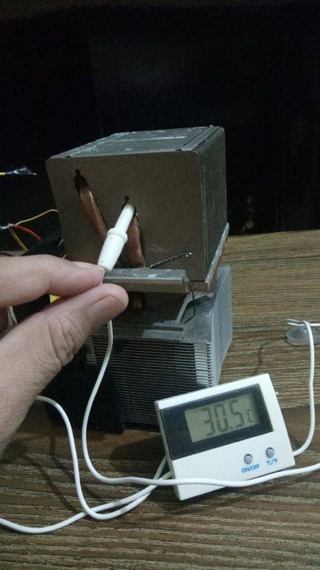

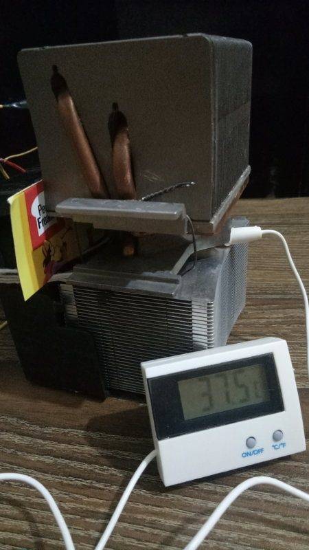

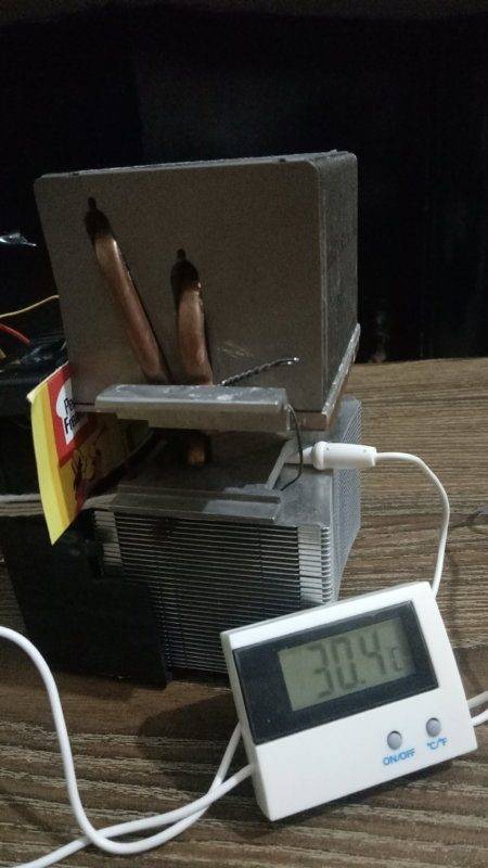

Here are heatsink temperature figures
Before Start - Hot side = 30.40 degree
Before Start - Cold Side = 30.50 degree (it should same might be, I just wait a little bit to match both)
After 12 Minutes - Hot side = 37.50 degree (almost 7 degree up)
After 12 Minutes - Cold Side = 25.70 degree (almost 5 degree down)
So it makes 12 degree heat difference at few inches gap.
Hot side temperature before start = 30.40 degree
Cold side temperature before start = 30.50 degree

Hot side after 12 minutes = 37.50 degree
245363

Water drops on cold side pipe after 12 minutes
245365

I visited freezer and air conditioner repairing shop to see split air conditioner cold pipe (attached to outdoor unit) insulation material and I found that it was same material/foam that's used to lay down under carpet. Same kind of foam. So I will get that sheet to properly insulate heatsink.
I bought Water Cooling Radiator for 2 Peltiers (80mm), that was mistake however I should buy 2 radiators of 40mm each so I can attach both Peltiers on 2 different sides of heatsink for better results so cold cold spread in heatsink from 2 sides.
Now I have planned to arrange 3 Peltiers + 3 Radiator + new water pump + insulation sheet for final experiment. If this works (which I believe will work) then I will start work on proper body for this mini air conditioner.
I already have rough idea to use metal body like APC 1000VA UPS. That kind of body is good for this device with 4" x 4" fan at front to throw cold air at 2-4 feet distance. (I already have this fan and this fan throws air very at very good speed). Three chambers in that body. Back chamber is for power supply and any other electronic kit, etc. Middle chamber is for cold generation unit (heatsink, etc.) which will move cold air into front chamber. And front chamber with insulated steel box will receive cold air from cold generation unit and throw outside. I will use insulated steel box in front chamber so when cold air will pass on from this place then that steel box will absorb/store cold (I mention at start that I have an idea to use cold drink can in different way) before cold air is thrown out of box. So as long as device is running 20 degree cold air is flowing from front cold box that box will keep cold and help to throw enough cold air at 2-4 feet distance. Its just my idea, don't know it works or no.
So this kind of idea but all depends on my final experiment with 3 Peltiers on all 3 sides of heatsink with powerful fans at front and back. If 2 Peltiers on top of heatsink can drop heatsink temperature from 29 to 19 in just 15 minutes then 3 Peltiers on all 3 sides will give much better result.
Let's assume if heatsink temperature is dropped to 10-15 degree in just 15-20 minutes and when air will flow through this heatsink, will that not give enough cold air? No matter if cold air flowing out from front side is 25 degree cold (temperature drop during flow due to any reason), its sufficient.
Heatsink is very good and I will looking for this kind of heatsink that absorbs cold from all side with cross plates so air struck with these plates to get cold. Heatsink outside wall width is 1cm and inside plates width is 1/2cm. Excellent piece to absorb cold even device is shutdown for few minutes.
19 degree temperature of heatsink in 15 minutes with 2 Peltiers I achieved yesterday.
245490
I still believe this will work.
James
