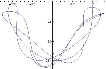

Here's the figure from Serway. The figure appears to show the mass moving horizontally at the bottom (θ = 0). This would not be true in general.
However, if the spring doesn't stretch very much during the swinging, then the velocity will be approximately horizontal at the bottom and the mass can be thought of as moving approximately on the arc of a circle at the bottom. You can check that the spring is pretty stiff. Hanging the mass on the end would only stretch the spring by about 2.6%.
Under this approximation you can set up energy and centripetal force equations to get an approximate solution. I find that the answers using this approximation agree pretty well with answers obtained from numerically integrating the equations of motion: about 2.4% error in yf and about 0.29 % error in v at the bottom, if my calculations are correct.

I just plotted it up in a spreadsheet. It seems that the numbers given have been carefully chosen so that the trajectory is quite simple. It swings symmetrically, with the side-to-side oscillation having twice the period of the stretch/contract oscillation. Maybe if you write out the differential equations and look specifically for a solution of that form it all drops out, but I still think that's a long shot.
If you analyse the vertical oscillation of the spring and the horizontal oscillation of the pendulum separately (at, say, equilibrium length for the vertical position), maybe they'll give the 2:1 period ratio, but I hardly think that's valid. The interactions could lead to a completely different result.

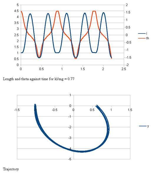

That was what I was hinting at in my first post, but retracted because I couldn't justify the arc-of-circle assumption. Looks like the critical parameter is kl/mg. When this is large (it's about 40 here), it probably is near enough.
It looks very different with smaller ratios. E.g. at 0.77 it gets very lopsided. When the mass is back at the original height, the spring is only half the length on one side as when it's on the other. When in the vertical position, there is still some vertical velocity.
Right, when the ratio kl/mg is considerably smaller than for the given data, you get some interesting motion.

Here are graphs for kl/mg = 0.77

That looks like what I'm getting. Here's a case where I changed k to 200 N/m so that kL/(mg)≈ 6.1.
