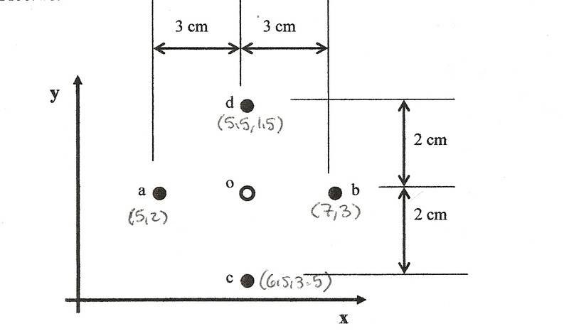

The velocity components in a plane (i.e., 2-D) flow are measured at four points as indicated in the sketch at the bottom of this page (see attached doc. I wrote in the coords). The velocity components at the respective points are, in units of cm/sec:
[tex]u_a=5, v_a=2, u_b=7, v_b=3, u_c=6.5, v_c=3.5, u_d=5.5, v_d=1.5[/tex]
a) Estimate the percentage change in volume of a fluid parcel at the central point o.
b), c) no questions thus far on my part
divergence of V = 0 for incompressible fluid (assumption made in problem since we haven't done compressible flow yet)
So, I figured that since the divergence of V = partial(u)/partial(x) + partial (v)/partial(y), the partial(v)/partial(x) and partial(u)/partial(y) components don't need to be calculated (i.e., v_a, v_b, u_c, u_d are not relevant). Is this a correct assumption? If so, I took
(u_b-u_a)/2(dx)
= (7-5)/2(3) = (1/3)
and (v_d-v_c)/2(dy)
= (1.5-3.5)/2(2) = (1/2)
so div(V) = (1/3)-(1/2)
= -(1/6)
Thus, the total change in volume at the central point is (-1/6).
Does this make sense, or am I approaching the problem incorrectly?
(u_b-u_a)/2(dx)
and (v_d-v_c)/2(dy)
= -(1/6)
You are on the right track, but there is a problem in your interpretation of the answer, -1/6.
What are the units associated with this number? If it's not obvious, review how you calculated it, and the units of the numbers that went into the calculation.
Also, recall that the question asks for a percentage change.
