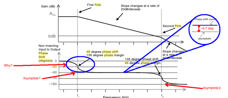

Hello guys please help me on this...

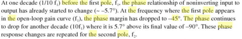

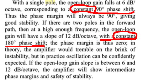

The next hurdle in my understanding of frequency compensation comes as following…
As the text says…
My problem is that as we move from point 1 to 2, the frequency increases so the phase shift should also increase..(as phase shift depends on frequency)… but the text however says that the phase shift will be constant at 90 deg with a 6db roll off..so what is this paradox..??
Either the text should say that "open loop gain falls at 6db/ octave with a varying phases shift of 90 deg..”
Isn't...!
No - why do you think that the phase shift is ALWAYS increasing with frequency?

* For poore resistive circuits the phase hift is always zero
* For an ideal integrator (or a RC network for very large frequencies) the phase shift is constant at -90deg.
Example second order:
H(s)=A/(1+as +bs²)
For very high frequencies we have H(s)=A/s²= - A/w² .
And the "-" sign is identical to a constant phase shift of -180deg.
(This is what the text says).
However, the text is somewhat simplifying. The term "constant" refers to the asymptotic lines of the real curve phase=f(frequency). As the above function H(s) shows: The phase assumes 180 deg for infinite frequencies only.

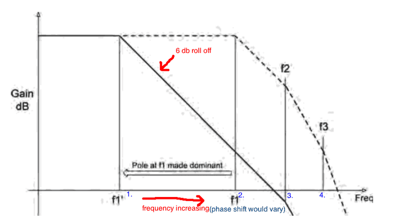

Oh I am really sorry..I forgot to attach an image...which will present my point of query..
What I mean to say is that if we move from point 1. to point 2. frequency is increasing...correct..so the phase shift should also become more prominent..
But in the text it is written that or means that for a 6 db roll off the phase shift would be a constant 90 degree...(as we progress down the slope the frequency on the horizontal axis increases)
So why they said that the phase shift would be constant...either they should say "open loop gain falls at 6db/ octave with a varying phases shift of 90 deg..”

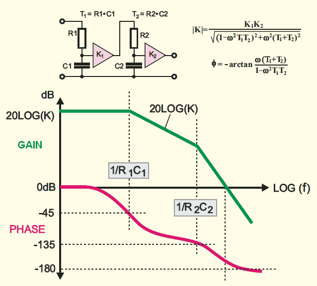

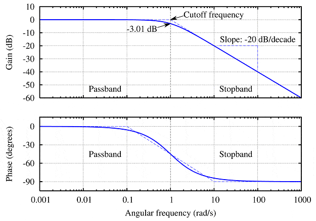

In short. The dominant pole capacitor (single capacitor) can provide only 90 deg phase shift max.
And we select dominant pole capacitor in such a way that the loop gain drops to 1 with slope 6dB per octave at a frequency where the poles of uncompensated amp contributes very small to the total phase shift. This ensures that the phase shift is greater than -180 deg and we have a stable amplifier.
See the plot (single pole)
And notice that for F > 10*Fc phase shift is constant and equal to -90 deg.
Where Fc is a cutoff/corner frequency Fc = 1/(2 * pi * R*C).
Also do you know why roll-off is equal to 6dB per octave (20dB per decade) ? If not you should really back to basics.
And here you have a example of a second order (two poles) frequency response
Likes brainbaby and jim hardy

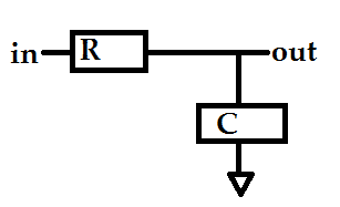

Here's where technicians get an advantage
my high school teacher had us boys calculate, tabulate and plot, calculating by slide rule , on log paper
Vout/Vin for this simple circuit
from a couple decades below to a couple decades above break frequency
Vout/Vin = JXc/(R+jXc)
now - when you struggle through that exercise with all its slide rule polar to rectangular conversions
you'll see the pattern emerging
At low frequency Xc >> R so that fraction's denominator is very nearly jXc
and fraction jXc/(nearly jXc) is nearly 1, with almost no phase shift because the j's almost cancel (pardon my math liberty?)

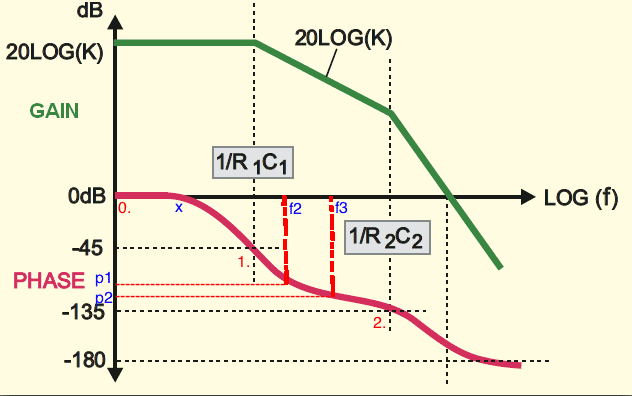

As we all know that a capacitor introduces a 90 deg phase shift...right..yes ...I agree that phase shift depends upon frequency...
Being indirectly I mean that... see the figure in post 5..here for uncompensated curve at point 2 ..a 90 deg phase shift is introduced...and in between point 2 and point 3 the frequency is increasing but the phase shift is same i.e 90 deg...,now at point 3 again another phase shift of 90 deg is introduced...and the accumulated total phase shift is 180 deg..but again in between point 3 and point 4 frequency is increasing but phase shift is yet the same 90 deg...
So this behaviour felt to me like that the points (2,3,4) where there is a roll off(pole) the phase shift depends on the frequency and for the rest intermediate positions frequency is independent of phase shift...
However by saying that frequency is independent of phase shift I never meant that it does not depends on phase shift...yes it depends ..but it was just a way of me inferring the situation...as simple as that...
To be exact: A capacitor introduces a 90 deg phase shift between voltage and current!
For an RC element we have a frequenc-dependent shift which reaches 90 deg for infinite frequencies only!
No - the phase cannot abruptly change its value (...a 90 deg phase shift is introduced).
Study the phase response in Fig. 6 - it tells you everything you need to understand what happens.
Such "phase jumps" are only introduced in the drawing for the asymptotic lines as a help for constructing the real and smooth phase function.
Frequency is always independent on phase shift. I suppose you mean the inverse: Phase shift independent on frequency.
But this is NEVER the case. Phase shift ALWAYS depends on frequency.
Don`t mix the real phase response with asymptotic lines which serve only one single purpose: A help for roughly constructing the real curve. See the phase diagram in Fig. 6 and realize that the final value at -90 deg is reached for infinite frequencies only.

My inference from figure 6...
1. Phase shift non linear function of frequency..2. Phase shift is independent of poles because it started changing from point x before the first pole have occurred.3. Between point 1 and 2 the phase shift is 90 deg which is said in the text to be constant because they are talking in terms of accumulated phase shift which is 90 deg..(135-45=90) < as phase cannot arbitrarily change its value>..but with each change in frequency the value of phase shift is different as seen from the curve (for f2 and f3 phase shift is p1 and p2)..…which further signifies that phase shift totally depends on frequency…however that dependence is non linear..
Am I right ?
1.) The term "constant" in the text (your post#1) is not correct. We have a constant phase shift of 90 deg for an IDEAL integrator only (pole at the origin). However, such a circuit does not exist.
2.) Your point (2) is false. It is the pole which causes the phase to deviate from its starting value (0 deg) already for very low frequencies.
3.) For my opinion, the diagram shows everything you should know to understand what happens. If there would be no second pole, the red curve (phase) would approach the -90 deg line (which acts as an asymptotic line in this case).

jim hardy said:
let's take a plausible example
R = 1000 ohms
C = 1 microfarad
time constant = 1 millisecond
pole then is at 1000 radians per sec = 159.15 hz
and Xc at 1000 radians/sec is 1000 ohms
a decade away, at 15.915 hz what is transfer function's magnitude and phase ?
Xc = 1/(2pifC) = 1/(2 ⋅ π ⋅ 15.915 ⋅ 1X10-6) = ⋅1.0X104
jXc/(R+jXc) = j104/(103+j104)
which = 104∠-90°/1.005X104∠-84.3° = 0.995∠-5.7°Phase shift doesn't know anything in advance. Mother nature just built math that way.

All phase shift in the circuit are caused by a reactive components (capacitor and Inductor). This two components provide inertia in the circuit because the electric field and magnetic field cannot change instantaneously the time is needed. And this is why we have a phase shift.
For every single pole (low pass filter) circuit the frequency response looks the same.
We have a single pole at frequency when Xc or XL = R.
For R-C circuit it will be at Fc = 1/(2 * Pi * f * RC) and for L-R circuit Fc = R/(2 * Pi * f * L)
And the slope will roll-off at 20 dB/decade (6dB / octave) because for example a 10 times increase in signal frequency will correspond to 10 times increase in XL or 10 times decrease in Xc. And this is why the circuit "gain" will by frequency dependent. And the phase shift will also by frequency dependent because Xc/XL is changing with frequency. And at pole we have a -45 degree phase shift for a single pole.
Likes brainbaby
Jony130 said:
And the phase **** will also by frequency dependent
...following the arctan function.
Likes brainbaby

earlier I use to think that roll off happens only at a rollover frequency...wp=1/RC...which I previously thought to be certain...but in your following quote you told me a fact that actually the decrease of amplitude takes place at very low frequency (f=1E-12 Hz) though hard to measure... so that's why I thought that one cannot be absolutely certain at all times..it mere conditional...(depends upon condition)
LvW said:
remember the simple RC lowpass with a pole at wp=1/RC. The decrease of amplitude with a corresponding phase shift will start already for f=1E-12 Hz (and even below).
  • #33
I rather think, it depends not on certain conditions but on the degree of simplification one is able to accept.
To make it clear: At the pole frequency "starts" the roll-off of the asymptotic line that is used as an aid for constructing a much more realsitic curve of the phase response (which begins to deviate from the starting value much earlier).
  • #34
that's the trouble with umpteen-digit calculators
by slide rule it's obvious from the t or srt scale when phase has got so close to its asymptote as to 'have arrived'
but the calculator goes out probably beyond twelve digits ,
one has to 'think analog' to realize the number has effectively quit changing.
  • #35
brainbaby said:
.in electronics one cannot be absolute...like there is nothing certain.
actually if something is true at a certain condition..doesn't necessarily mean that it would be true at other conditions as well...
I don`t know if I completely understood the meaning of these sentences - but It could be the truth replacing "certain" by "absolutely correct".
Let me explain: In electronics nothing is absolutely "correct" (formulas, explanations) because we always make simplifications and neglect some minor influences. This makes sense and is necessary - otherwise we would arrive at formulas which cannot be handled and evaluated. The most simple example is a resistive voltage divider which - of course - has some capacitive and inductive influences. However, as long as these influences are smaller than parts tolerances or other unwanted and/or unknown influences from other sources it makes much sense to treat the divider as "pure resistive".
However, there my be other situations ("conditions" as you say) where some simplifications are not allowed anymore.
Another example: We must know within which limits we can treat an operational amplifier as ideal. Otherwise, it can happen that an opamp-based circuit suddenly behaves unexpected or even begins to oscillate.
Summary: Each formula or function contains simplifications - and it is the task of a good engineer to know under which operating conditions these simplifications are allowed and will cause errors/deviations which are within acceptable limits.
