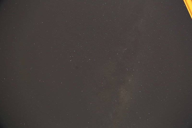

have a look at these two images
the first one is the xxx.jpg straight out of the camera that I took at home in the city with tons of light pollution, I can only see the brightest stars
seriously blah looking !

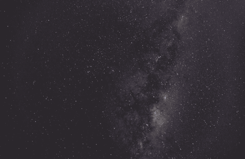

here below is the same photo, the RAW version edited in Lightroom to get rid of the light pollution and do just a little contrast
and sharpening enhancement and finally a little cropping to get rid of the last of the vignetting and the corner of the house roof
Now, you tell me, which one would you prefer to look at ?
Canon EOS 5D Mark III
F/4
30 sec exp
ISO 800
24mm focal length
