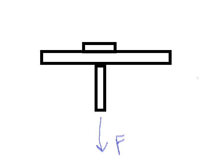

Homework Statement:: If you have a 1" thick steel plate (A36) with a 1.125 hole (supported at 3" half way around), what is the maximum weight that a 1" grade 8 bolt can support using a 2 to 1 safety factor. The weight is applied directly the the bolt
Relevant Equations:: dunno?
it's been 24 years since I've looked at this. any help would be nice.

Can you say what the application is? Also, can you post a sketch or CAD drawing of the setup? That would be a big help. Thank you.
I can't. the "bolt" has 30k lbs force pulling straight down on it and I want to see if the 1" plate will support it. it is a weldment.

it will actually have about 22.5k on it. I just want to try an figure out the force that a 1" plate could hold like that. If 1" is too thin, i'll put 2" or 3". Just trying to get info and explanations and formulas.

There are standard formulas and tables for number of bolts required on a gusset (for say a truss for a given tensile load). Should be useful.
That is not what I'm asking. Double shear and single shear do not apply this. What I'm trying to figure out is the shear strength of the plate with 1 single bolt through 1 single plate. Deflection is not a factor due to bracing and such. I just need the strength of 1 bolt being pulled straight through a plate.
Then I believe you are talking about tensile strength and probably need to talk to an engineer.
No, it will be plate shear.
