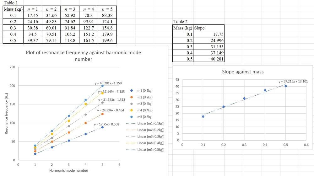

In summary: A bit of info regarding the experiment that was performed:- A piece of string was attached to a vibration machine that will oscillate the string. The vibration machine is also connected to a signal generator that controls what frequency is chosen.- At the end of the string a mass is attached. (Starts from 0.1kg and increases to 0.5kg in 0.1kg increments). The length of the string from the vibration machine to the point of contact on the opposite side is 1m. (This is L in the experiment.)In summary, these are the questions that I can't figure out how to do:- Find the values of μ by re-arranging equation 1
ghdalswn Source htt
Using the value of μ, plot a graph based on the data from a table and vice versa.
f=(n/2L) (√(T/μ)) (equation 1)
μ =T(n^2)/(4L^2)(f^2)
f frequency (Hz)
n Harmonic mode number (1,2,3,4,5)
L Length of string (1m)
T Tension of string (N)
μ linear mass density (mass per unit length)(kg/m)
These are the questions that I can't figure out how to do.
I have been assigned a lab report based on resonating frequencies on a string and am having trouble completing some of the questions in the report. This is what i currently have from the previous steps required.

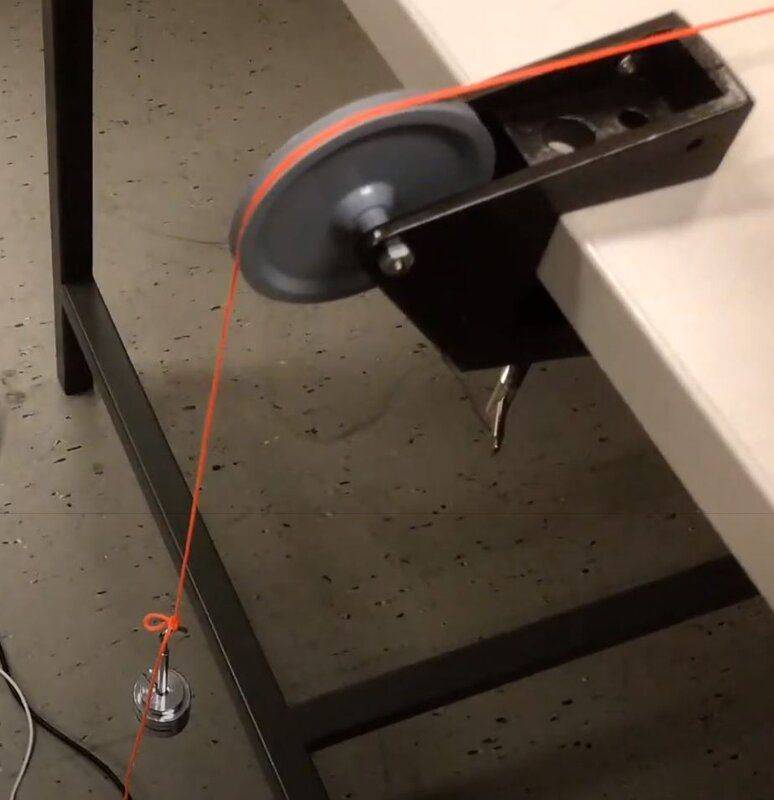

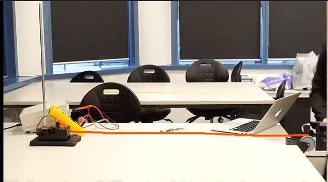

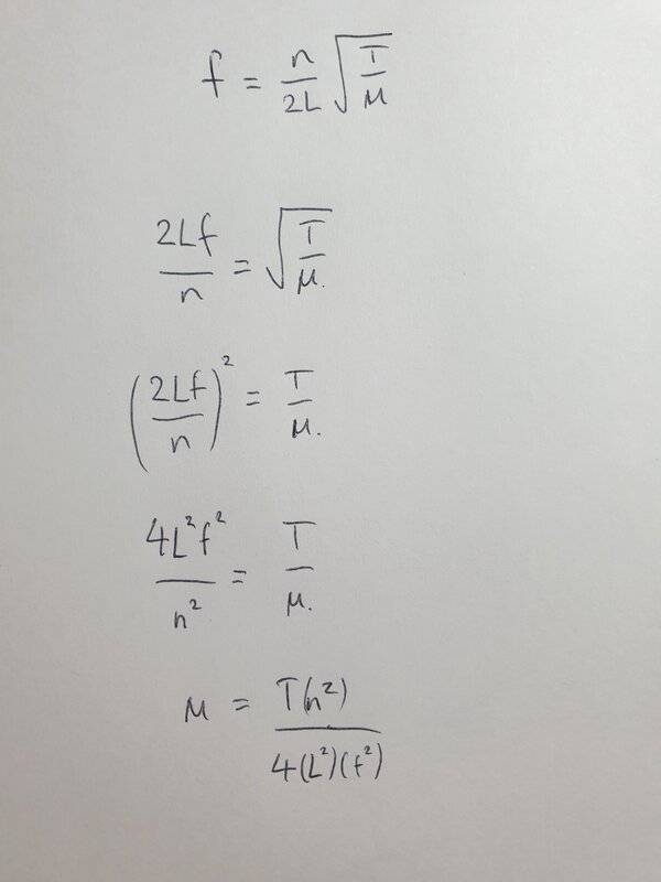

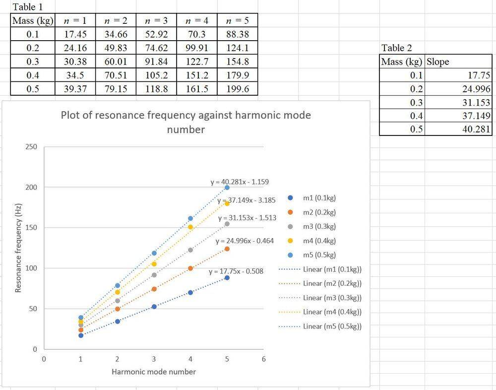

I don't know what to do next. I tried finding the values of μ by re-arranging equation 1. I made μ the subject.
So far i have (8.0 ± 0.5)10^-4 kg/m and (8.0 ± 0.9)10^-4 kg/m for m1 and m2. (m1 and m2 are the mass 0.1kg and 0.2kg respectively). I got these values by placing in the numbers, from table 1, into the formula i derived. I did this for all rows for mass 0.1kg(m1) and mass 0.2 kg(m2) to eventually find the best estimate (i added all the derived values and divided by 5) and the uncertainty (highest value - minus lowest value then divided by 5). However, i don't think this is the right direction as I didn't get how to link these values in regards to table 2.I would be very thankful for any assistance.
It is not at all clear, but I think you are to rearrange the equation into the form ##y=\mu x##, where y is a function of some of T, L, f, n and x is a function of the rest. Then plot y against x.

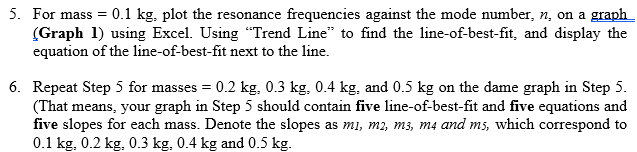

Did you find them in a flower bed? The values themselves are unimprtant o us. Tell us how you obtained these values !
m1 and m2 are new players in your story -- they were not mentioned earlier. If I have to guess, they are ##\mu_1## and ##\mu_2## for the two wires for which the experiment was done. So I expect to see two plots 1 instead of one. But why do you force your helpers to guess ?

m1 and m2 are new players in your story -- they were not mentioned earlier. If I have to guess, they are ##\mu_1 ## and ##\mu_2##
As I read it, m1 and m2 are the masses of two strings of different length, but they all have the same ##\mu##.

Sorry, i can see how my post was very confusing to read from an outside perspective. I have added changes that can hopefully explain my actions.
I have added an image of how i re-arranged the original formula to find values of μ. I thought that i would need to find the values of μ , along with its uncertainty, for each mass. The values that i found were the best estimate and uncertainty for mass 0.1kg and 0.2kg (m1 and m2).
haruspex said:
That was for an earlier part of the question.
I did add a graph that the instructions told me not to do and have removed it now. M
Yes, m1 and m2 are the masses of the strings but they were of the same length.

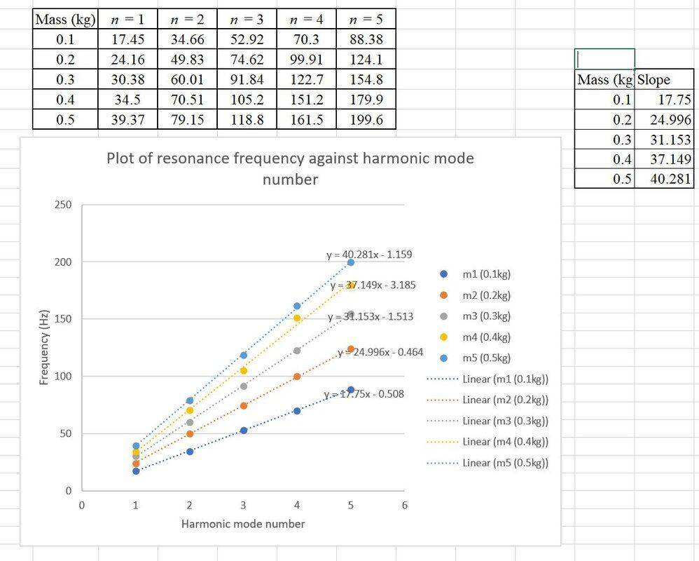

Ok, so there is one experiment with one wire and one ##\mu##.
You have made a plot of ##f## versus ##n## for five different masses. The relationship is clearly linear. What are the slopes (expressed in the symbols used) ?
This thread is becoming very hard to follow with all these deletions and additions !
Sorry about that.
What are the slopes (expressed in the symbols used)?
Does this mean to express the slope in terms of the equation?
The slope is the frequency over the harmonic number. So slope = f/n = 1/2L (√(T/μ )

Yes and yes.
So you have five times slope(i) for five masses ##m_i##
Side note:
Did you notice that I was utterly wrong with
the instructions used those for the slopes ?:) -- very bad and confusing idea -- and you used tehm to distinguisg the fibve lines -- slightly better idea -- and we now all use them to designate the weights used in ascending order of mass.
In this second round of the analysis, as Zz suggests to his students: figure out what is varied and what is measured.
What was varied ? The mass of the weight.
What was 'measured' (observed): the slope: ##\ \Biggl( \displaystyle {\ \ {1\over 2L} \sqrt{ T\over\mu} }\ \ \Biggr )\ ##.
Side note 2: Do not make the mistake of writing this as 1/2L (√(T/μ ) -- You'd be a factor L2 off at some miserable moment . If you can't avoid it, write 1/(2L) (√(T/μ ) -- still ugly, but at least correct.
Where does the independent variable pop up in the symbols ? Not in ##L## and not in ##\mu## but in ...
Right, so (indirectly) in ##\ T\;##: ##\ T_i = m_i\,g##.
How does one obtain a usable plot to determine ##\mu## ? You square the slope and make a plot of that versus ##i##. Look at it acrefully and decide if that really gives a better linear dependency than the plot (slope versus ##i##) that you originally had in post #1 but later deleted.
The (much sought after) relationship is $$
{\sf slope}^2 = \; {1\over 4L^2}\ { i \times 0.1 \;{\sf kg}\;g\over\mu }$$ so a linear fit gives you $${1\over 4L^2}\ { 0.1 \;{\sf kg}\;g\over\mu }$$ and from that you get ##\mu##.
My guess is you are not yet at the level that an in-depth error analysis is required (Am I right?).
Working this way you have ued statistics to minimize (random) measurement errors and kept all the factors that are systematic (contributing the same in each measurement) in the intermediate result. Here that is mainly ##L## and to a lesser extent the 0.1 kg, as well as g.
