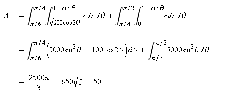

I apologize for the late response, but I'm sorry I still don't understand what you mean by when it goes negative? I've tried conceptualizing it.
The solution for this problem was also posted by my teacher, but I am still trying to grasp it.
In the first integral, I can understand where the ##\frac {\pi} {4} ## is coming from, as it's the upper bound of the leminscate, but I plotted the image, and the ##\frac {\pi} {6}## seems to correspond to nothing on the region, it seems arbitrary.
I also don't understand why the second integral changes its bounds to (pi/6, pi/2) all of a sudden... I'm just not understanding these bounds at all.

Well, you are interested in only one part of the lemniscate which is located inside the white circle.
If you were to plot the equation for the lemniscate, starting at θ = 0, you would have a point located at approximately (14.14,0) on the positive x-axis. However, this point is located outside the region enclosed by the white circle.
What you want to do is calculate the angle at which the lemniscate and the circle intersect after θ = 0 and before θ = π/4; in other words, solve ##100 sin (θ) = \sqrt{200 ⋅ cos (2θ)}## for θ. This value of θ becomes the lower bound of your integration.
Okay, thank you, it completely slipped my mind that the theta still traversed the leminscate even after pi/4. My only issue now is solving this equation, which although it is algebra, I'm not have a very good time with it.

##100sin(\theta) = \sqrt{200cos(2\theta)}##
##50sin^2(\theta) - cos(2\theta) = 0##
##50sin^2(\theta) - (1 - 2sin^2(\theta))=0##
##50sin^2(\theta) - 1 + 2sin^2(\theta))=0##
##52sin^2(\theta) - 1 =0##
##sin(\theta) = \frac {1} {\sqrt{52}} ##
##\theta = sin^-1(\frac {1} {\sqrt{52}}) ##
Not really sure what to make of this. How do I get an exact value for the bounds?
You can't, because there isn't one, except as shown in your calculations.
You can check your solution by substituting this angle into the equations for the lemniscate and the circle and obtaining the coordinates of the point of intersection.
