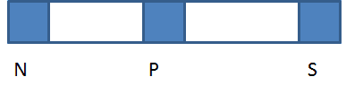

I'm trying to calculate the battery requirements for an experimental home built air compressor. I understand that electromagnetic air compressors operate using attraction and repulsion forces created by electromagnets using the basic magnetic principle that like poles of two magnets repel and opposite poles attract. I 'm trying to calculate two things. Firstly the force required to repel a permanent magnet, which acts as a piston, through a cylinder with diameter 2cm and length 30cm. Secondly how much electrical power in watts it would take to create sufficient magnetic force to repel the piston at one end and attract at the other end.. I believe the SI unit for magnetic force is N (Newton meters). Is there a formula I could use to determine these two measures? .

P - Piston (permanent magnet)
N - North
S - South

Thanks for your feedback. I've googled and googled but would you believe there are currently no commercially available tubular electromagnetic air compressors, unless I'm missing something. There are many planar ones used for clutches, fish tanks and aquariums etc. These operate over very short distances. I'm trying to replicate a hand pump to pump up bicycle tyres, hence the cylinder 2cm diameter by 30cm length. By reciprocating piston do you mean one that uses a crankshaft? I'm trying to avoid that. The diagram above shows what I'm trying to achieve. Its a sort of free piston that gets pushed from and pulled to alternating poles of two electro magnets. The piston is a permanent magnet and the electromagnets change polarity from north to south and back to north and so pushes and pulls the free piston through the cylinder which I'm hoping will be powerful enough to compress air. The cylinder has a input valve for sucking in air and an output valve for compressing air into a tank. Any thoughts on how I could calculate these two variables? (force and watts)

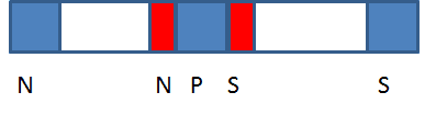

Don't forget that electromagnets and permanent magnets alike all come with a North and a South. So if the piston has one end N and its other end S, then the polarities at the cylinder extremes should work together: both simultaneously N or simultaneously S.
Hello, Yes the piston will have both a north and south pole as shown above. Will this affect the efficiency? Is this why this type of compressor isn't commercially available?

That's still not right. [emoji86]
The cylinder's end poles need to be the same.
