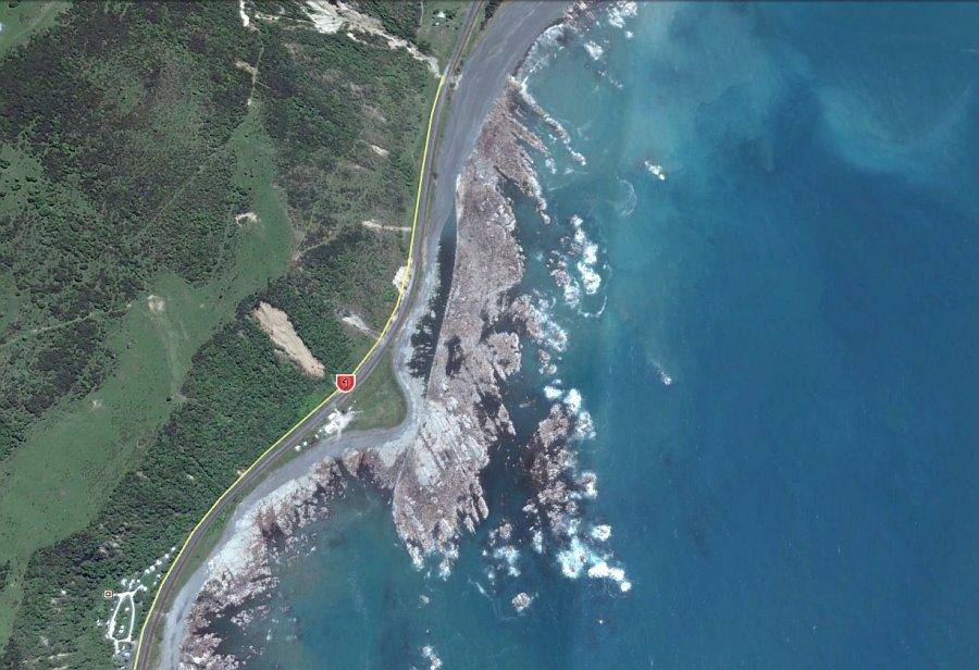

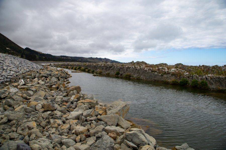

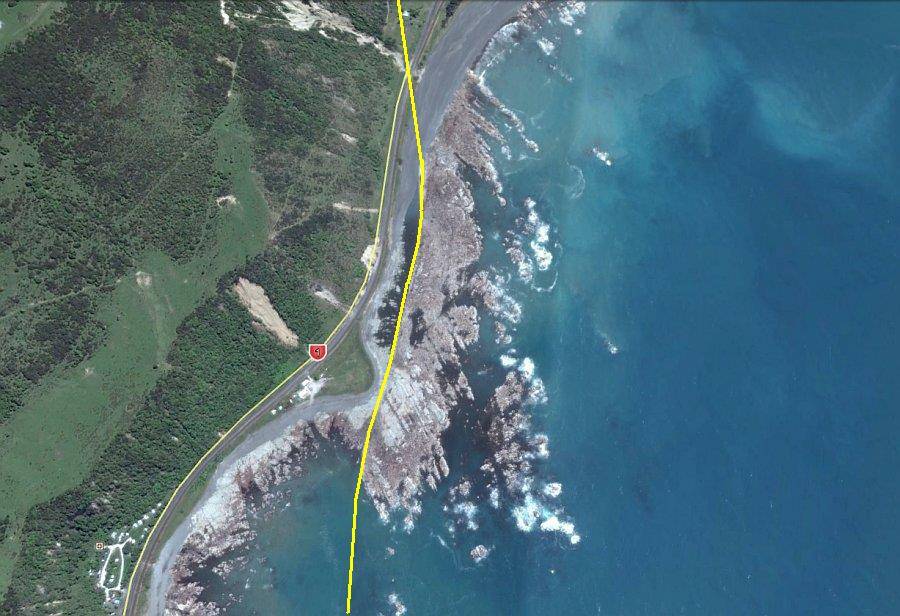

Here's a fault I visited recently in the NE of the South Island of New Zealand. This is one of a number of faults that were both on-land ( mostly) and some were coastal that the combined rupturing produced a Mw7.8 event in November 2016.
This fault is partially on-land and runs offshore. It's mapped length is around 3km
The greatest offset observed is 2m vertical and 6m horizontal. It uplifted some 10km of coastline that once used to be submerged at high tide but now is well above high water level.
my photos
looking along a long section of the rupture
View is NW, uplifted side is seaward side. Around 1 - 1.5 metres beside me
further NW along (~100m) the fault and at the largest vertical offset, ~ 2m
Sadly the dumping of rock from the various landslips has almost covered the fault
Google Earth aerial view
This uplift produced a small tsunami along the coast of around 1m
