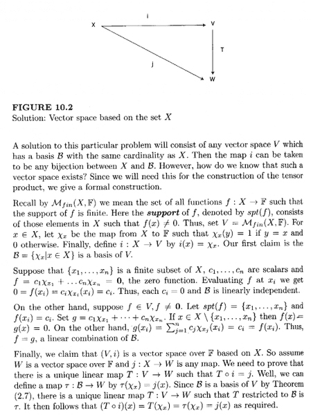

I am reading Bruce N. Coopersteins book: Advanced Linear Algebra (Second Edition) ... ...
I am focused on Section 10.1 Introduction to Tensor Products ... ...

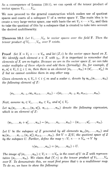

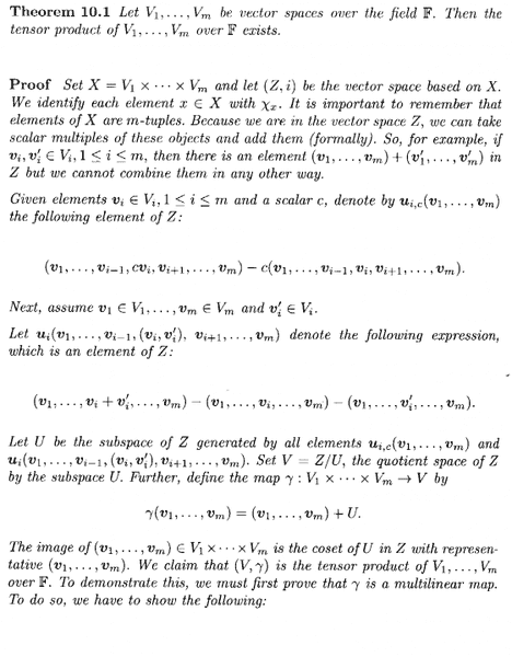

I need help with the proof of Theorem 10.1 on the existence of a tensor product ... ...Theorem 10.1 reads as follows:
In the above text we read the following:
" ... ... Because we are in the vector space [itex]Z[/itex], we can take scalar multiples of these objects and add them formally. So for example, if [itex]v_i , v'_i \ , \ 1 \leq i \leq m[/itex], then there is an element [itex](v_1, \ ... \ , \ v_m ) + (v'_1, \ ... \ , \ v'_m )[/itex] in [itex]Z[/itex] ... ... "So it seems that the elements of the vector space [itex]Z[/itex] are of the form [itex](v_1, \ ... \ , \ v_m )[/itex] ... ... the same as the elements of [itex]X[/itex] ... that is [itex]m[/itex]-tuples ... except that [itex]Z[/itex] is a vector space, not just a set so that we can add them and multiply elements by a scalar from [itex]\mathbb{F}[/itex] ... ...
... ... BUT ... ...

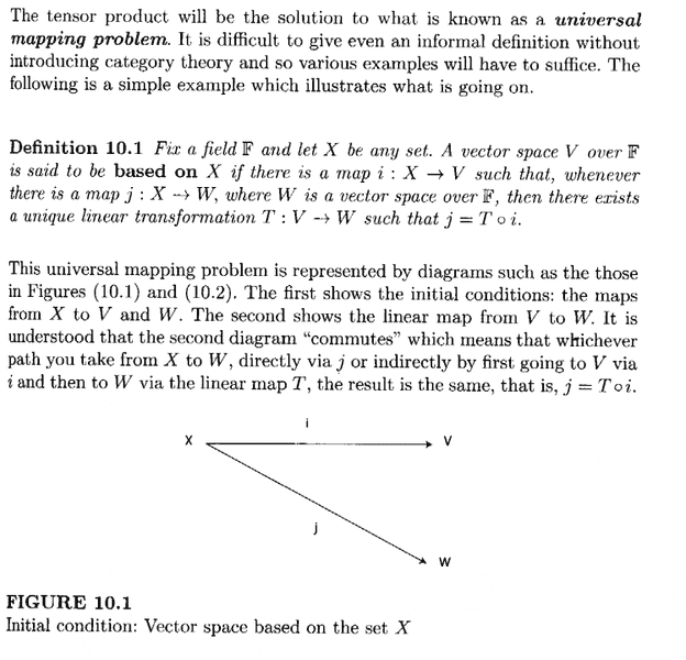

... earlier in 10.1 when talking about a UMP ... Cooperstein discussed a vector space [itex]V[/itex] based on a set [itex]X[/itex] and defined [itex]\lambda_x[/itex] to be a map from [itex]X[/itex] to [itex]\mathbb{F}[/itex] such that
[itex]\lambda_x (y) = 1[/itex] if [itex]y = x[/itex] and [itex]0[/itex] otherwise ...
Then [itex]i \ : \ X \longrightarrow V[/itex] was defined by [itex]i(x) = \lambda_x[/itex]
... as in the Cooperstein text at the beginning of Section 10.1 ...

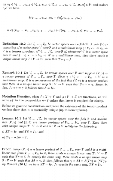

The relevant text from Cooperstein reads as follows:

Can you explain what your difficulty is with this text? You haven't asked an explicit question.
Sorry Andrew ... explicit question is as follows:
So ... given the construction and the definitions in the text directly above from the beginning of Section 10.1 ... and comparing this with Theorem 10.1 ... it appears that in the case of the beginning of Theorem 10.1 where [itex]Z[/itex] takes the place of [itex]V[/itex], the elements of [itex]Z[/itex] should be of the form [itex]\lambda_x[/itex] ... not of the form [itex](v_1, \ ... \ , \ v_m )[/itex] ... ... ?Can someone please clarify the nature of the elements of [itex]Z[/itex] ... are they of the same form as the elements of [itex]X[/itex] ... that is m-tuples ... or are they of the form [itex]\lambda_x[/itex] ... ... ?
Hope someone can help ... ...
Peter
The answer is in the second sentence of the proof, where it says 'we identify each element of ##X## with ##\chi_x##' (by the way, you wrote ##\lambda_x## above where I think you meant ##\chi_x## - chi, not lambda).
That means the author is going to pretend that they are the same thing, because it doesn't make any difference to the validity of the operations they will perform.
Personally I don't like identifications like this. I find it sloppy, lazy and it generates unnecessary confusion, as it has done with you. In my experience it can nearly always be avoided without any significant extra work.
By the way, this is a very complex presentation of tensors, which is completely unnecessary unless you want to understand them from a Category Theory point of view. The reason for all his weird definitions seems to be because he wants to fit tensors and vector spaces into a Category Theoretic framework. If you don't feel the need to do that, just go with a non-categoric presentation of tensors and vector spaces. It's just as rigorous. Vector spaces are very simple objects, and tensor spaces are not that much more complicated as long as you understand the notion of quotients.

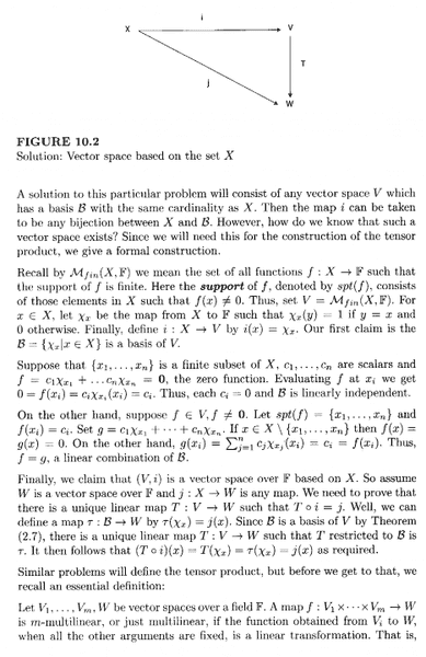

... thanks to Andrew, mathwonk and micromass for your previous posts on this topic ... I have been doing a lot of reflecting on what you have said ... but still have some issues ... hope you can clarify things further ... especially the representation of elements of \(\displaystyle V\) ... I wish to pursue further Andrew's point about identifying each element [itex] x \in X [/itex] with [itex] \chi_x [/itex]
Although I now understand that an m-tuple is a function ... I am still unsure about what is going on in Cooperstein's move in Theorem 10.1 where he considers the elements of the vector space [itex]Z[/itex] to be of the form [itex]( v_1, v_2, \ ... \ ... \ , \ v_m )[/itex] ... ...
Now Cooperstein defines [itex]V[/itex] by [itex]V = \mathcal{M}_{ fin } ( X, \mathbb{F} )[/itex] ... ...
So [itex]V[/itex] is the set of all functions [itex]f \ : \ X \longrightarrow \mathbb{F}[/itex] such that the support of [itex]f[/itex] is finite ... ...
Cooperstein defines [itex]\iota \ : \ X \longrightarrow V[/itex] by [itex]\iota (x) = \chi_x[/itex] ...
... and shows that [itex]\mathcal{B} \{ \chi_x | x \in X \}[/itex] is a basis for V ...So an element of [itex]V[/itex] would be (I think ... am I correct?)
[itex]f = c_1 \chi_{x_1} + c_2 \chi_{x_2} + \ ... \ ... \ , \ c_m \chi_{x_m} [/itex]and another element would be[itex]f = c'_1 \chi_{x'_1} + c'_2 \chi_{x'_2} + \ ... \ ... \ , \ c'_n \chi_{x'_n} [/itex]and we could formally add these so
[itex]f + f' =[/itex] [itex] ( c_1 \chi_{x_1} + c_2 \chi_{x_2} + \ ... \ ... \ , \ c_m \chi_{x_m} ) [/itex] + [itex] ( c'_1 \chi_{x'_1} + c'_2 \chi_{x'_2} + \ ... \ ... \ , \ c'_n \chi_{x'_n} ) [/itex]Is that right?... ... BUT ... ... in the proof of Theorem 10.1 Cooperstein writes the elements of V as [itex]( v_1, v_2, \ ... \ ... \ , \ v_m )[/itex] and [itex]( v'_1, v'_2, \ ... \ ... \ , \ v'_m )[/itex] ... ...
... ... ? ... ... is this just a convenient way to write [itex]f[/itex] and [itex]f'[/itex] ... ? ... if so, is it a problem that f and f' may have a different number of terms in their sums due to different supports ...
How is Coopersteins terminology of [itex]( v_1, v_2, \ ... \ ... \ , \ v_m )[/itex] for an element of V justified?
Peter

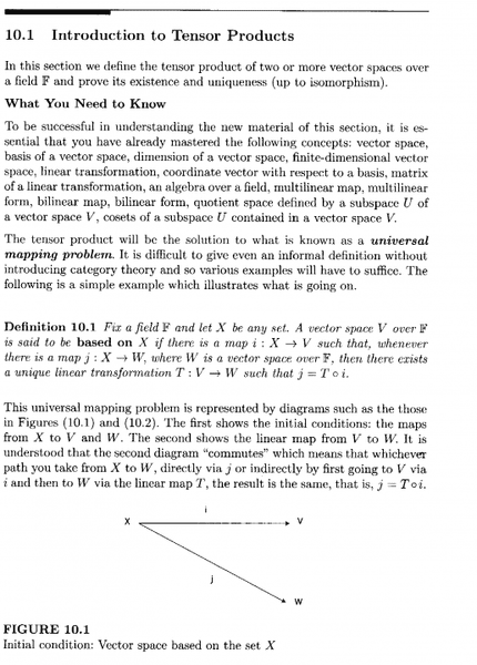

===========================================================For the convenience of readers of this post I am providing the text of Cooperstein's introduction to Section 10.1: Introduction to Tensor Products ... ... the text will include the statement of Theorem 10.1 and the start of the proof ... ... as follows:

Since the last posts in this thread I've been doing a little exploring the alternative definitions of tensors and tensor products, as:
- quotients of a vector space of formal sums; or
- multilinear maps.
I have discovered a few interesting things along the way, including the realisation that my guess in post 15 that one needs an inner product in order to identify a canonical isomorphism between a vector space and the dual of its dual was incorrect. It turns out that, although one cannot uniquely identify the dual of a vector without an inner product, one can uniquely identify the dual of the dual of a vector.
As I've wandered through various considerations and possibilities, I find myself becoming increasingly convinced that the multilinear map approach is preferable. Not only is it easier to understand, but it also avoids the need to be constantly identifying different isomorphic objects in order to prevent one's equations becoming - strictly speaking - meaningless.
I think the quotient approach is very rewarding as a means of providing an additional perspective, once one has already developed a sound understanding of tensors. It's always good to have more than one way of looking at something. It may also be the case that the quotient approach provides a better base for launching into the study of symmetric and antisymmetric algebras. But I'm struggling to find an advantage of the quotient approach over the multilinear map approach other than those two.
Perhaps somebody prefers the quotient approach can suggest some aspects of it that they find preferable. @mathwonk I mulled for some time over your comment
