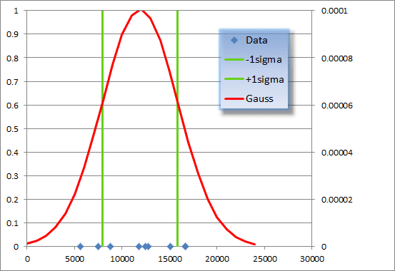

I can reproduce averages and sem for 1 and 3. Typo in 2 ?
Just considering them as nine independent observations gives an average of ##\ (11.9\pm 1.3)\times 1000\ ## and two-thirds of the measurements are within ##\pm \sigma = \pm 4000 ## from the average.
But looking at them as three groups gives means that are so utterly distinct ( ##12300\pm 300, \ 7300 \pm 900, \ 16100\pm 500 \ ## ) that it is very hard to believe they can be from the same population.

means: how accurate do you expect your measurements to be ? ##\pm 4000## ?

The way you describe it there are other factors, not under your control, that influence the outcome. Statistically you should obtain a Gauss distribution for a large number of repeats. With only three sets your estimate for the standard deviation of the over-all distribution will be rather inaccurate, though.
In such a case I would consider the nine observations as independent and end up with the 11900 ##\pm## 1300 and a standard deviation of 4000.
