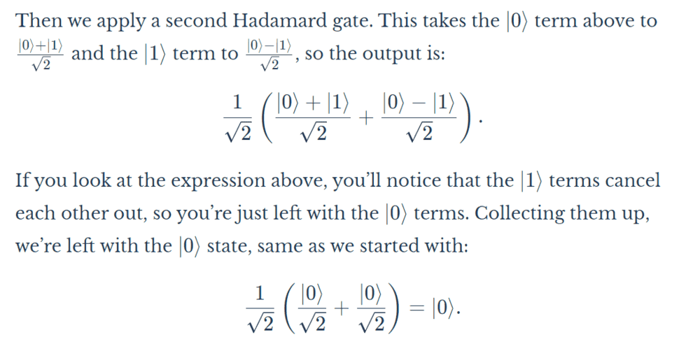

Cannot entirely understand why some of the terms cancel each other out while double Hadamard gates are applied.
Hi guys, I am an absolute beginner in quantum computing. I am really curious about its mechanics but my lack of knowledge in mathematics makes me struggle. I cannot entirely understand why numbers |1> cancel each other out while double Hadamard gates are applied. If the rule is to cancel out the same numbers, why then |0> stays the same, as well as the √2? Thanks
The ##0## and ##1## inside the kets ##|0\rangle## and ##|1\rangle## are not numbers; they're labels for basis vectors in a vector space. You could just as well call them ##|A\rangle## and ##|B\rangle##, or ##|\text{Laurel}\rangle## and ##|\text{Hardy}\rangle## for that matter, and everything would be the same.
The rule for adding vectors is that you add them component by component, i.e., you add up all the terms involving each basis vector separately. So you have:
\frac{1}{\sqrt{2}} \left( \frac{|0\rangle + |1\rangle}{\sqrt{2}} + \frac{|0\rangle - |1\rangle}{\sqrt{2}} \right)
equals
\frac{1}{\sqrt{2}} \left( \frac{|0\rangle}{\sqrt{2}} + \frac{|1\rangle}{\sqrt{2}} + \frac{|0\rangle}{\sqrt{2}} - \frac{|1\rangle}{\sqrt{2}} \right)
equals
\frac{1}{\sqrt{2}} \left( (1 + 1) \frac{|0\rangle}{\sqrt{2}} + (1 - 1) \frac{|1\rangle}{\sqrt{2}} \right)
equals
\frac{1}{\sqrt{2}} \left( 2 \frac{|0\rangle}{\sqrt{2}} \right)
equals
|0\rangle

Ahh, I see! I really appreciate your help, it's not the first time you are spending your time and patiently explaining me things. Thanks a lot man
