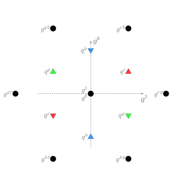

On the Wikipedia site for quarks, I found this diagram. There is no reference to individual quarks. But it does seem to suggest that a gluon travels only from one type of quark to its anti-quark version. For example, in the diagram, the ##g####g\bar b## gluon is between the ##q####g## quark and the ##\bar q####b## anti-quark. Does this mean that the ##g####g\bar b## gluon must travel between any quark of color green and any anti-quark of color blue? (I thought anti-quarks can only have anti-color.) Or does this mean that the ##g####g\bar b## gluon can only travel between a ##u## quark and a ##\bar u## anti-quark, or can only travel between a ##d## quark and a ##\bar d## anti-quark, or can only travel between a ##s## quark and a ##\bar s## anti-quark, etc? I'd appreciate any help in reading this diagram. Thanks.
No, and I don't know how you got that idea. Check Feynman diagrams of gluon exchange.
No.
Correct.
That diagram is group-theoretical in origin and shows the charges under the diagonal SU(3) generators. It has nothing to do with gluons "travelling" between quarks. In order to understand the diagram you need to understand group representation theory, which it is not clear to me from this thread if you do or not.
Also note that when you encounter Feynman diagrams they are really not pictures of particles flying around (although physicists will often talk about them in a manner that might suggest that to a layman), they are graphical representations of mathematical terms in a series expansion. There is also some caveats for representing colour in Feynman diagrams ...
I don't see the problem. Use whatever language you're would like. I'm sure things can get complicated with superpositions and different basis. But the language used in the figure means something. Correct me if I'm wrong, but it seems obvious that ##\bar q## is an anti-quark whereas ##q## is a quark. The down pointing blue triangle must mean anti-blue, since anti-quarks on take only anti-colors. And the ##g\bar b## in the symbol ##g####g\bar b## seems to indicate what color is being changed by that gluon. If someone could explain what pair of quarks can possibly be changed by ##g####g\bar b## and how they are changed, this would be very helpful.
