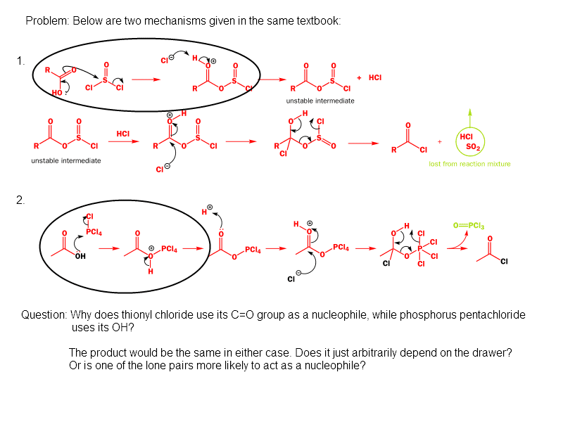

Question about which oxygen acts as a nucleophile

I posted in picture format to post on another website, but haven't found a reply yet:

However, by analogy with other reactions of the carbonyl group I'd think this is likely to involve effectively internal attack on the C=O by the COH, and work from there. Proton transfer, however is fairly rapid so the two mechanisms are pretty identical. Whether a kinetic isotope effect may be present in pure deuterated acid, I don't know.
You're question is a little unclear because the mechanism shows nucleophilic attack by a -COOH group. The oxygens in these groups are actually equivalent and are best represented by resonance structures where the hydroxyl and carbonyl oxygens exchange.
I was able to find an answer - the protonated carbonyl is the correct mechanism for both (the second is a mistake). You can see why by considering resonance.
No, they are equivalent in the carboxylate anion, but not in the protonated version. Resonance structures do not involve the movement of protons.
You are correct sir. I shouldn't be answering questions when I'm dead tired.
