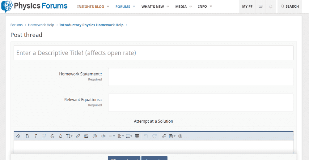

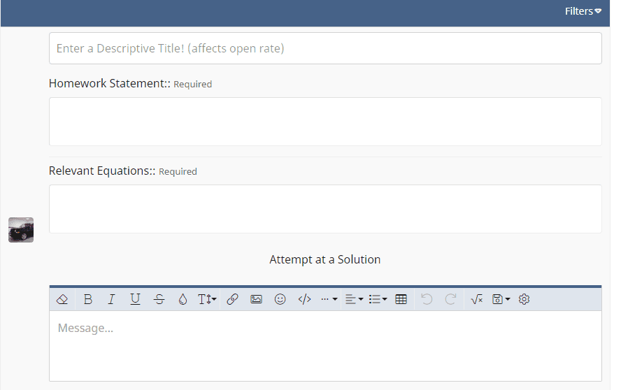

(the problem is that I m not understanding how you ask a question here )
Probably because I typed 19.6133 instead of 19.6 like you I have the answer different from yours, so another mistake by the teacher, that s bad , ok thanks for now
I press
forums,
Introductory Physics Homework Help
and I fill up this , have to be different as where to write ?
chriscarson said:
I press
forums,

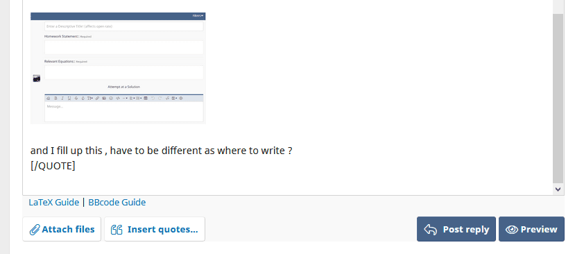

Sorry, are you asking where the LaTeX Guide / tutorial is? It's in the lower left of the Edit Window, as shown in the screenshot below. It is also available by clicking INFO, Help at the top of the page. :smile:
Also, when you clicked "Reply" to my post above with the LaTeX math in it, you could see what I typed to generate that LaTeX math rendering. :smile:
is this place ?
chriscarson said:
is this place ?
Interesting, I think I see your point. When starting a new thread, the LaTeX Guide link does not seem to show up at the bottom of the Edit Window. That looks like a bug to me, so I'll report it.

still I was not going to use it because I don t know the purpose but next time I will write in the last screen shot I sent you .hope I don t cause you trouble .
No trouble. We just like to help folks learn how to use the PF tools to make better posts, which helps you to get better replies (and helps us to reply to you). Feel free to send me a PM (private message, just click on my Avatar and "Start a Conversation) if you have further questions about how best to use the PF. :smile:
