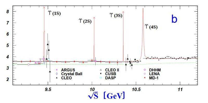

In the calculation of R=σ(e+e-→hadrons)/σ(e+e-→μ+μ-) from BaBar experimental data at a center of mass energy of √s≈10 GeV i obtain R=5. Theoretically I should get a value of R=10/3. I know it has something to do with the resonances of ϒ mesons shown in the plot attached, but I don't know how to explain it. Help please.
Using Monte Carlo simulation and finding the efficiency for the annihilation. Selecting only the events that passa a certain cut, I used σ=Nselected/(Lε) where L is the luminosity and epsilon the efficiency found with Monte Carlo.
I think I'm suposed to get this value and explain it with the ϒ meson, but I don't know how and I didn't find any explanation in any book. Thank you.
Then something is wrong with your Monte Carlo or the efficiency treatment.
What are the cross sections you got?
The ϒ mesons don't matter if you are at exactly 10 GeV or generally not inside one of the resonances.
The exact center of mass energy is √s=10.539 GeV
σ(e+e-→μ+μ-)=782 pb
σ(e+e-→hadrons)=3917 pb
That is inside the ϒ(4s) peak. Sure, that changes the values. You probably get something between the R-value outside the resonances and the ϒ(4s) decay modes.
Could you give some insight about what decay modes could increase the value of σ(e+e-→hadrons) and how would that increase the cross section please?
Check the decay modes and see which interaction is leading to them. It is not the electromagnetic interaction.
Looking in the PDG website I can see that the decat into B Bbar is the most favourable decay. Is that enough to say why the hadronic cross section is so large? Or should I also look the decays of B Bbar? According to PDG the most favourble decay for B is a leptonic decay, which I don't see how would increase the hadronic cross section, it should in fact lower R as the cross section into muons would increase, wouldn't it?
The R value considers the direct collision process only. B mesons are hadrons, their decay modes later don’t matter.
Which interaction leads to the decay to two B mesons? Can you see why the derivation of the R value doesn’t work there?
The weak interaction leads to the two B mesons, right? But I still don't see why the R value doesn't work.
Until know we've seen that the e+e- decays into ϒ(4s) which at the same time decays into B mesons thus increasing the cross section for the decay into hadrons right? I don't understand why the derivation for R doesn't work under this procedure.
Why would you expect the weak interaction to be relevant?
Even if it would: Why would you expect it to follow a rule that is based on electric charges?
e+e- doesn’t “decay” to ϒ(4s).
The R-value of 10/3 comes from the assumption that the e+e- pair interacts via a virtual photon. Only in this case are the electric charges relevant. An ϒ is not a photon.
I think I'm starting to understand. So the ϒ is generated when the e+e- annihilate into quark and antiquark via electromagnetic interaction, but the B mesons are generated via the weak interaction on ϒ, so they are not taken into account for the rule of R=10/3, thus increasing that value?
There is no weak interaction involved.
The ##\Upsilon## is a resonance, it has a cross section way above the process you consider to get R=10/3 for other energies.
It decays via the strong interaction with nearly 100% probability, and that decay produces hadrons.
