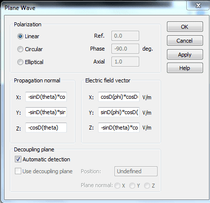

I'm trying to understand how CST measures the RCS of an object. If not specified by me, it gives me (with a very brief simulation even for complex objects) graphs, both 3D and 2D, entitled 'Bistatic RCS'. With this wording I think that there is an antenna in a different direction than the one from which I send the plane wave incident on the target, which receives the reflected wave. However, I never specified the presence of a second antenna, nor did I tell it where it is.
What is it showing me? I do not understand.
It also shows me another number that it calls 'Total RCS' that I don't even understand what it means.
Help, please?
Thank you.
I can't post geometry, but I can post screenshots describing my procedure.

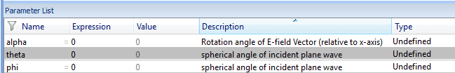

I have a plane wave excitation with the following setup:
246479
where the angles are parametrized:
246481

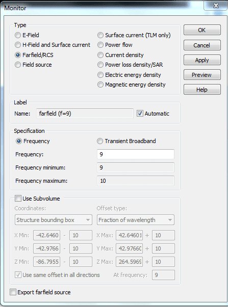

and a field monitor for RCS:
246480

So, if I don't make comprehension errors, I'm asking CST to do 4 simulations for theta = 0, 60, 120, 180.

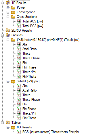

Launching the simulation with the settings described above I get the following results:
246484
In particular, in the 'Farfields' folder, the subfolder named '(f=9) theta=...' contains monostatic RCS results. For example, choosing 'Theta' under this subfolder, I see:
246485
where I don't understand why I find written, besides phi = 0 (which is the reference plane that I asked for), also phi = 180 (without points, apart from those strange red lines that go straight into the origin).
Choosing instead 'Theta' from the subfolder 'farfield (f = 9) [pw]' ([pw] stands for...?), we get this graph:
246486
As you can see it is titled 'Bistatic Scattering RCS', I don't understand what he has calculated and who asked him to do this type of calculation too.

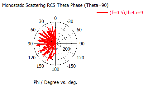

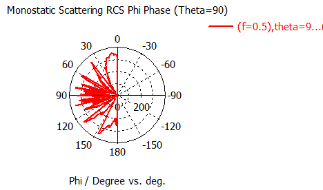

If anyone can reply, I also ask what does the results 'theta phase' and 'phi phase' means in a CST Radar Cross Section simulation.
I don't think that they are the phase difference between the sent plane wave and the received plane wave, because:
1. I have not said to CST what is the distance between the antenna (the same for TX and RX in monostatic RCS calculations) and the target under test;
2. the Radar Cross Section is defined as a ratio of real quantities (absolute values of the incident and the received fields), so no phase is present in the definition.
Thanks in advance.

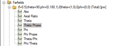

Unconscious said:
. . . a message of mockery.
No, not mockery. . . just friendly banter between Tom G and myself.Carry on. . . . :smile:
Tom.G said:
I would guess that theta is angular position of the target relative to the antenna.
Yes, in general CST has a reference cartesian frame, from which one can switch in a spherical frame with ##(r,\theta,\phi)## variables.
In a RCS problem in CST, one sends a plane wave on a target (a 3D draw made by the user). The direction of such a plane wave is dictated by the angles ##\theta_0## (angle between the propagation direction and z-axis) and ##\phi_0## (angle between the projection on xy plane of the plane wave propagation vector and the x axis).
From this, the simulation result that I expect is a function of the couples of angles ##(\theta_0, \phi_0)##, whose arrival domain contains all RCS values in ##\mathrm{m}^2## (or ##\mathrm{dBm}^2##), that CST calls 'abs RCS' . I can also restrict the simulation results fixing one angle, for example ##\phi=0##, and making the other moving.
This is, instead, what I obtain:
In addition to 'abs', in the results folder there are many other things, whose significance is obscure for me (no mention on them was made in the CST help guide). In particular there are 'theta phase' and 'phi phase', that CST shows as:
An hypothesis could be that these two results are the phase difference between the sent plane wave and the received plane wave, but this sounds strange for me for the reasons exposed in #10.
