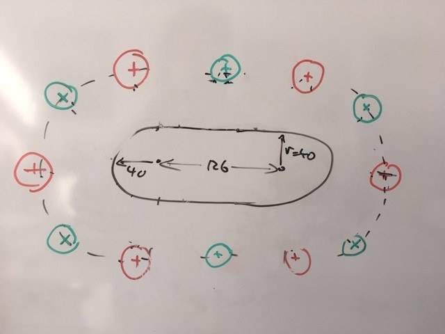

I want to have a constant distribution of heat flux around a muffle chamber (shown in fig) using 12 Radiation heat sources.
The distance bewteen the Body wall and the sources should be in between 40 and 80mm. The distance between the sources should also be kept constant.

I am trying to move the heating Elements around the "Muffle chamber"(Yes it is a furnace in a Simulator used to heat the specimen) so that I get the same intensity of Radiation at all Points on the muffle chamber.
GOAL : To achieve same intensity on all Points on the Surface of the Muffle chamber.
Initially I tried to keep the heating Elements as shown in figure and calculated the intensity of the Radiation on the Surface (on a certain number of points). But there's always some deviation (When plotted, the intensity on the Surface is not a straight line).
So i came to the conclusion that keeping the heating Elements in the axis as shown in the figure won't give the required result.

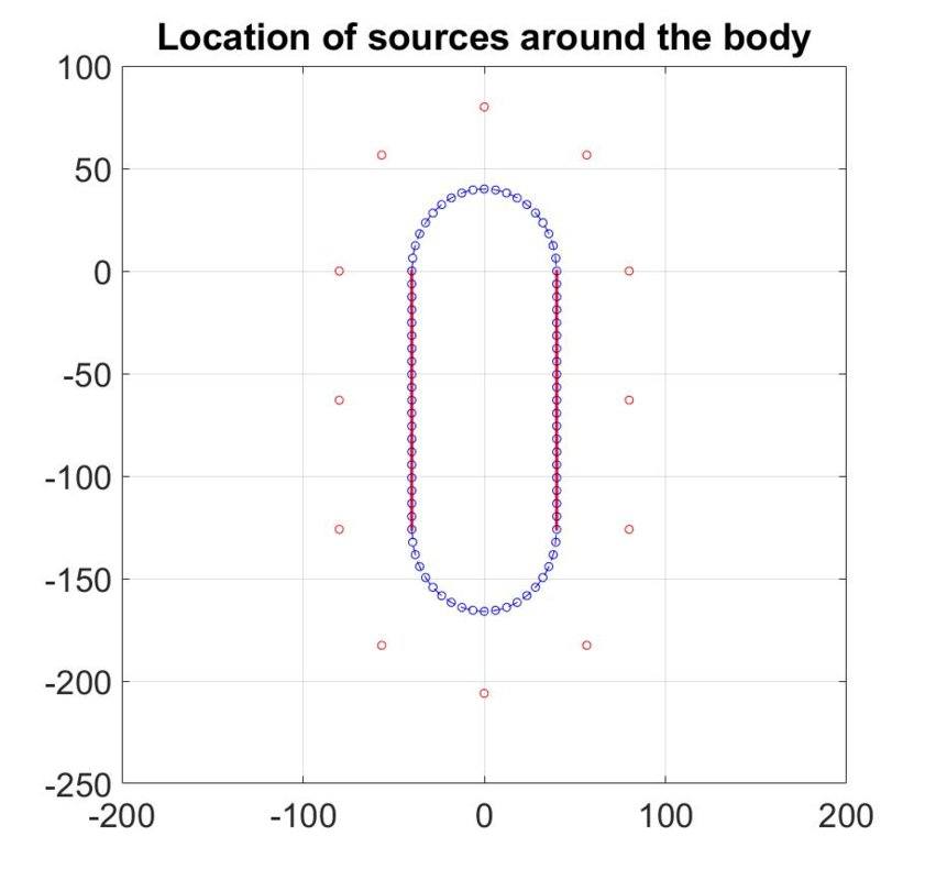

The heat Sources can be moved (Maximum distance between the wall and the heat source is 80mm).
I ran the calculations in MATLAB by varaying the distance between the Radiators and the muffle.
The heat source is a cylinder of 19mm Diameter. The whole set up is completely insulated and there is very Minimum loss to the surroundings. All the heat Radiators are operated at the same temperature for now.

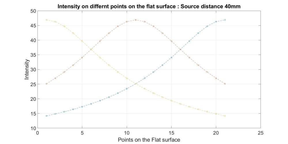

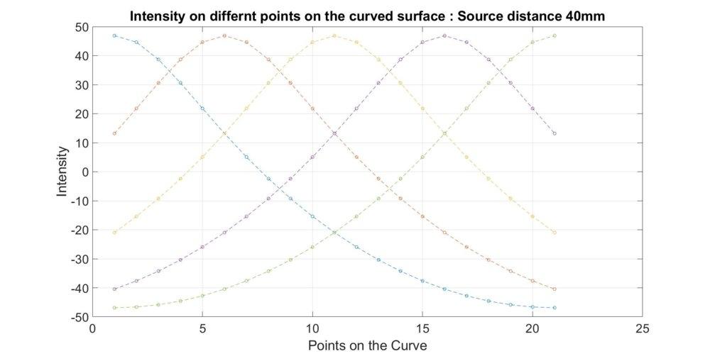

This is how I stared the Problem. I took the flat Surface on the left side and placed 20 Points on ist Surface. Also I took the top curved Surface and placed 20 Points on it.
I calculated the angle of incidence for all the considered Points on the Surface.
I already took into account the inverse square law and lambert's cosine law.
I = I' Cos(Theta).
I' = Intensity at Zero Degree / (distance between source and the wall)^2)
And I got the following result
Ignore the values on the negative side it is irrelevant.
As you can see the Variation of Intensities on the Point considered.
I want to have uniform heat intensities on all Points considered.
Can we add the intensities from two different Sources?
Say for example I think the intensity on Point 1 will be 46 and not (46+25+12) 25 and 12 are the contribution from other Sources.
Am I correct?
Thank you.
Yes, they will add... just like two lightbulbs in a lamp, the place get darker when one bulb fails. That was taken advantage of in the incandescent 3-way lightbulbs, they had two filaments and the 3-way was one filament, the other, both.

In the example I quoted in the previous Reply, the intensity at Point 1 is the sum of 46,25 and 12 i.e. 83. Not just 46.
Is there any kind of basic physics behind this addition of intensity. So that I could study more about this and understand it completely.
Thank you very much

The fundamental problem here is that you are trying to evenly illuminate a convex surface from a point source. The inverse square law and the curve of the convex surface make that impossible. It will require a curved mirror or a different shaped muffle.
If there will be a thermal equilibrium over some time, with energy traveling in both directions, you might replace the thin muffle with a thicker copper muffle that is able to transport heat around the walls. If you were exposing a curved photograph with a single flash the problem would be different.
Similar geometrical radiative problems will occur between the contents of the muffle and the muffle itself. What is being heated? How long will it be allowed to achieve thermal stability?
