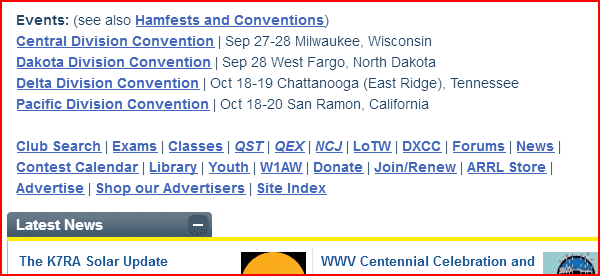

Yes, it is pretty inexpensive to get your HAM radio license and start learning more about radios. Plus, there are lots of HAM radio clubs with members who are happy to help you learn. Go to the ARRL website that I link to in my footer, and do a search for Clubs and license exams in your area. The club folks will be happy to let you know your various options for learning the basics so that you can pass your exam, and get you started learning about all sorts of radio stuff. :smile:
www.arrl.org
