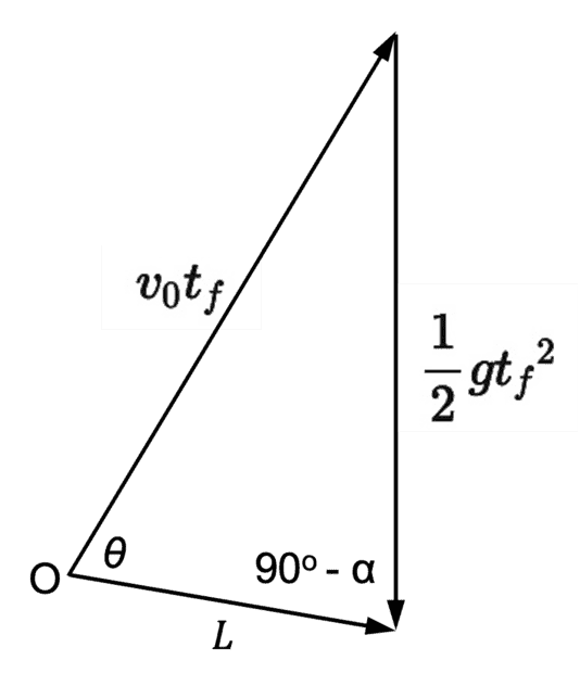

Calculation of Ramp Jump Distance Using Projectile Motion Formulas?
Amaretto
Two friends build a ramp with a 10° angle at both Sides of the shore in between is a creek. The travel with a Velocity of 7m/s where the acceleration is capped so they always drive 7m/s. What distance do they travel when they drive over the ramp? No Air resistance Nor friction. My Language is bad, I'm not native
g=9.81m/s^2
x(t)=x0+v0*t+1/2*a*t^2
b=10°
I created a Vector which describes the direction of the medium. with r=(x(t),y(t))=((x0+cos(b)*t+0*t^2/2),(y0+sin(b)*t-9.81*t^2/2))
I created a vector for the acceleration a=(0,-9.81)
Now only the y(t) is relevant since x(t)
acceleration is zero. sin,cos describe the direction of the velocity without acceleration.
Now i wanted to set y0=0 and find where y=0. Because i think thats the moment he lands. I solved 0=0+t*sin(10°)-9.81t^2/2 to find t and got 0.0355s put that into s=v*t and got like 25cm. I think there`s something wrong. What do yall think?

The time you found is incorrect. You need to find the correct solution to the quadratic.

So the equation is the problem. But I don't know where the mistake is or is the approach wrong. I'm sure I solved it properly. It was t= 2*sin(10°)/9.81
And where is the velocity of 7 m/s?

Now that I notice.. . Do i put it infront of sin?

What do you think? You said you want to do it by vector addition. What vectors are you adding?

I just put it infront of sin, since v0 is the starting velocity. I think 1.7m make more sense now. Thank you
The vectors that you add are ##~\mathbf v_0~t_{\!f}~## in the initial direction of motion and ##~ \frac{1}{2}\mathbf g~t_{\!f}^2~## straight down. Here, ##t_{\!f}## is the time of flight. These two vectors add to give the final position vector ##\mathbf L## as shown in the figure on the right.
