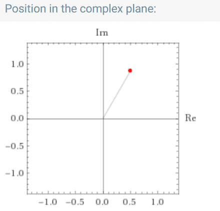

Wolfram alpha seems to give three roots, which correspond to different values of ##n##.

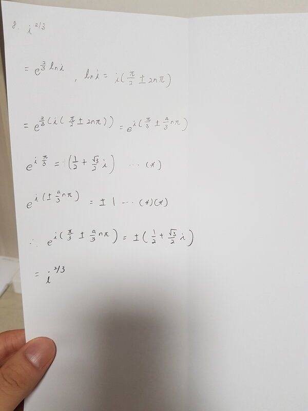

Well Thank you for your advice. I wil learn LaTex sooner or later.
But I really don't understand your answer, it's quite difficult that using arg. I don't have any ideas of arg method.here's my method below, can you please adjust my method?
and how can i find correct answer that book refer.

You mean here ?
To which I can subscribe. But:
And this site seriously claims ##i^{2/3} = -1 ## ? and also that ##e^z = e^{-z} ## ?

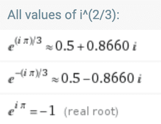

Down at the bottom it gives you one with all the roots on it:
We can take ##{(e^{\frac{5\pi i}{3}})}^{\frac{3}{2}} = e^{\frac{5\pi i}{2}} = i##. I don't think it is claiming ##e^z = e^{-z}##, it is just that ##e^{-\frac{i \pi}{3}} \equiv e^{\frac{ 5 i \pi}{3}}##, which is another solution.
It's slightly odd behaviour, but I wonder if that is down to the weirdness of rational exponents like in this case... I could well have this all wrong, if I am missing a key rule or something!
Perhaps I am the one with o:) egg on my face, stubbornly holding on to demanding a unique value in the complex world.
Here (at 4/5 into the page) is a counter-example (##i^i##) :
Another common pitfall is finding "the solution" to an exponential and assuming that it is the unique solution.
I'm inciined to ask @LCKurtz !PS And that would mean OP has 2/3 of the answers and his book answer only 1/3 !
It's definitely weird behaviour, and slightly confuzzling!

@coreanphysicsstudent
You changed which expression is labelled (*) and which is labelled (**).
This is correct: ##\displaystyle e^{i \pi/3}=\frac{1}{2}+\frac{\sqrt{3~}}{2}i## .
This is incorrect in general: ##\displaystyle e^{\pm i~ 4n\pi/3}=\pm 1## . Moreover, it doesn't follow from what precedes it in your work.
What you have preceding it is (you do not need the ± ) is: ##\displaystyle e^{i (\pi/3+4n\pi/3)} ##.
But ## \dfrac{\pi}{3}+\dfrac{4n\pi} 3 \ne \dfrac{4n\pi} 3##.
Rather ## \dfrac{\pi}{3}+\dfrac{4n\pi} 3 = \dfrac{(4n+1)\pi} 3 ## .
Try some values for ##n##.
No, the book answer presents all three:
"but the real answer is −1, (1±i√3)/2."
It comes down to the exact wording of the question. It is quoted as saying "solve i^2/3" but that doesn’t quite make sense. If it actually says "find the solutions of" then we are clearly not only concerned with the principal solution. If it says "find" then I would consider it ambiguous.
