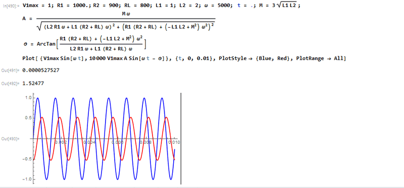

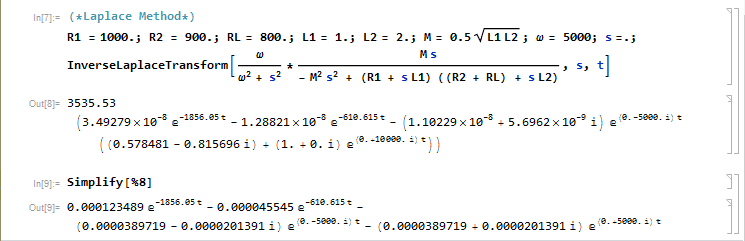

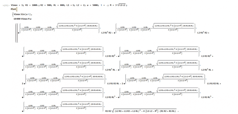

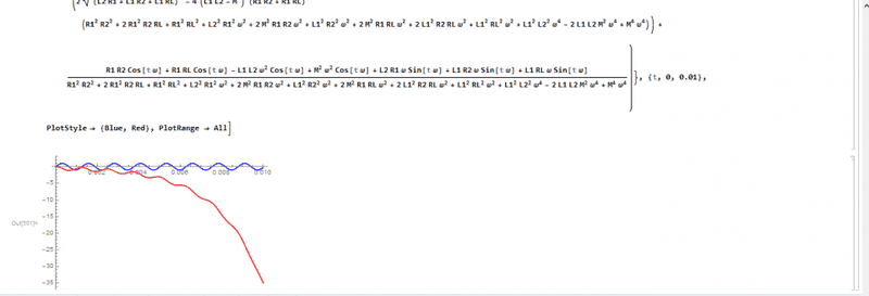

Sir Electrician. There is still a problem. I applied what you did in Mathematica using the expressions for the transformer. Attached are photos for the phasor one and the other one for the Laplace. I scaled both 10000x. It turns out that they don't look identical.

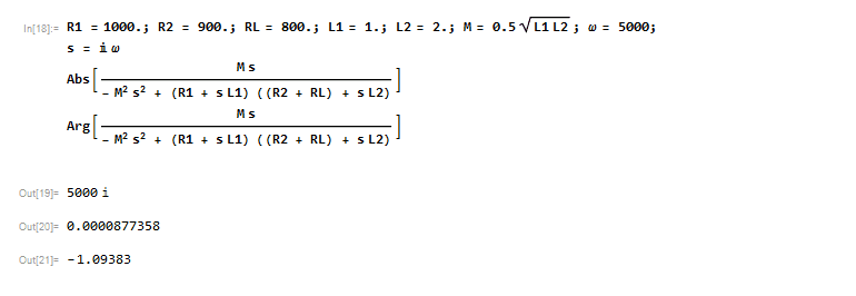

  • #46
One big problem is that your expression for M, namely M = 3*SQRT(L1 L2) is not possible. The 3 you have there is the coupling coefficient, and the maximum physically possible value is 1. I wouldn't even choose it to be very close to 1 or you might have numerical problems; I wouldn't set to greater than .95 I set it to .5 in what follows.

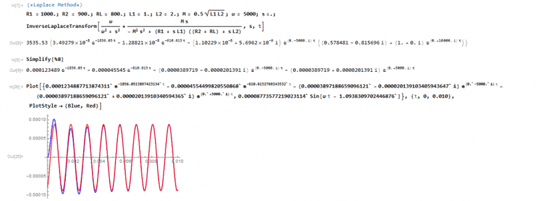

I can't tell if you got the right Inverse Laplace tranform, but you shouldn't keep all those exponentials when you plot the result. They are likely to cause numerical problems. Here's what I got; I only show the first two parts with the steady state part first in red, and the first exponential. Only keep the steady state part. There's a minus sign in front of the whole thing due to the particular choice of dots on the transformer windings; if one dot is moved to the other side, it will change the sign of the result:
Using the expressions for magnitude and phase derived from the phasor solution here's what I get for 1/magnitude and phase using your numerical values. I calculated the reciprocal of the magnitude because that's what you need to multiply the transform expression by to make the red trace fit the plot:
Here's a plot of the input sine wave including a phase angle of -1.09383 radians. I left its magnitude as 1 in this plot, and multiplied the Laplace expression by 1/magnitude. You can see that both blue and red plots are on top of each other. So the result from the phasor solution is identical to the result from the Inverse Laplace transform:
