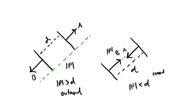

I find using dot product most convenient but it's up to you. If the object is facing each other exactly then their dot product will be -1.
Using distance method to decide if they're facing opposite each other or face-to-face: Imagine there's a point on the object face vector. Calculate the distance between that point with the second object face vector point. If they're facing outward, then the distance between those two points will be larger then the relative distance between the center of the objects. If they're facing inwards the distance will be less than it.
