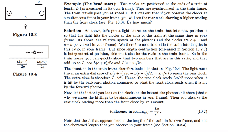

Ok, so here's an example from David Morin's book that I seriously don't understand:
Two clocks are positioned at the ends of a train of length L (as measured in its own frame). They are synchronized in the train frame. The train travels past you at speed v. It turns out that if you observe the clocks at simultaneous times in your frame, you will see the rear clock showing a higher reading than the front clock (see attached image). By how much?
Ok, so his solution is quite vague, he says that the time delay for the light going to the left relative to the light going to the right with respect to the train's frame is lv/c^2, that is clear. But why is it equal to the time delay of the clocks with respect to the outside observer?

OMG! Thank you very much! You just made me understand it, that's so awesome! Thanks! Morin should've left this later on after time dilation and length contraction. Since it is an example of simultaneity, the way I thought of it in his derivation is that if the two lights traveling inside the train has a time difference of lv/c^2 when one reaches the other end and the clock are simultaneous which are in the train's frame, then in the outside frame, it is the reverse, that is the clocks now have time difference and the light beams reach each end simultaneously, then therefore the time difference on each clock must also be lv/c^2...This thought doesn't even make sense but it seems to give the correct answer if we only think about simultaneity.
Morin's derivation is quite clever. By using the off-centre source and making the events simultaneous in the plaftorm frame, he avoids needing time dilation and length contraction. This shows that the relativitity of simultaneity is just as fundamental as time dilation.
The derivation I gave, I think, is more standard. But, I like Morin's as well.

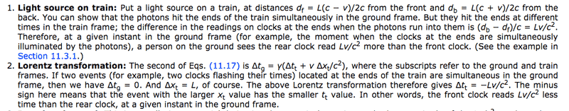

But we want the time delay in the S frame, because the question is asking what the time delay is as observed from the platform. The one Morin derived using Lorentz transformation is the same thing in the example, the time delay between the clocks. What he did though is to subtract the time for the events on each ends of the train in the train's frame which is the primed frame...But the question states that the clocks are synchronized on the train's frame so if we subtract the times in the primed frame, they should be zero..But he completely did the reverse
Here's Morin's derivation for the result. 1st one is the one above, 2nd he used Lorentz transform, but he used the primed frame to get the time delay, which should be zero in that frame but not zero in the unprimed frame...For the unprimed frame, what he should get is the one I did above
In his 2nd derivation he states that two events are simultaneous in the ground frame...But in his question, the clocks are simultaneous on the train frame, and the ground frame they are not simultaneous...Is he wrong then?

Oz123 said:
Ya, I seriously don't know. Like if we forget about the lights and just focus on the clocks, or if I just gave the question without Morin's solution. The answers might arrive differently.
What Morin is doing is using the Lorentz Transformation to show the relativity of simultaneity. The two clocks on the train are being illuminated by light pulses at the same time in the ground frame, which would follow on from his previous example of an off-centre light source. In this case, each clock is recording the time in the moving frame of an event at its location.
The clocks on the train are in sync in the moving frame, but are being illuminated at different times. Whereas, in the ground frame they are being illuminated simultaneously.
Likes Oz123 and vanhees71
ya I think I am getting it, thank you. I still am a bit confused, but I guess if we forget about the clocks and just think about the lights, it would work. Thanks a lot :)
