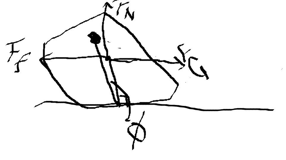

Why is the downward force Ff all on the axle of the cam is converted (through the cam’s rigidity) to an outward force Fr on the rock, which acts along the line from the axle of the cam to the point of contact with the rock and how are you able to relate cos Ff and N to those angles on the cam?
Ffall = 2Fr sinφ
N = Fr cosφ

Unable to understand how they deduct the relation between Ffall and N via the angles.
Unable to tell why this would act along the axle of the cam to the point of contact with the rod and be relatable to each other via the angle?
The model that I have in my head is that the gravitational force equals to the frictional force and there is a normal force, and that the gravitational force and the normal force do not relate to each other like this.

Can you attempt to draw the FBD for one lobe of the cam and post it?

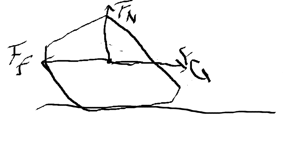

Specifically I don't see why Fn + Fg would equal a force that just happens to be at phi angle to the vertical. (this image should be rotated 90 degrees for the actual model)
##F_g## should act at the pivot, and there should be another force at the pivot from the other lobe.
##F_f## should act at the rock surface.
Your ##F_N## arrow wanders around a bit. It should be normal to the rock surface, not passing through the angle on the other side of the cam.

Statement 1 and 2, we're taught to draw fbd from the centre of mass in schools now LOL.
Statement 3 and 4, can't draw something without the wobbles with a mouse, it's meant to be normal.
Still don't see why Fn + Fg would equal a force that just happens to be at phi angle to the vertical.
Then how do you figure out torque balance?
Because if not then torques would not balance and the cam would rotate.
Likes aspodkfpo
