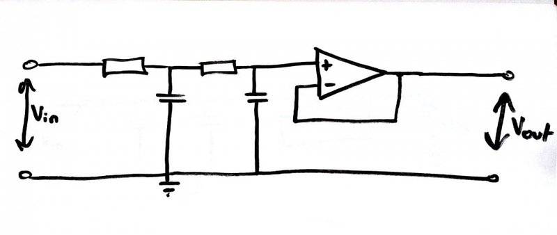

I need to design a second order filter with unity gain.
None - not taking component values into account for now.
Is this a correct method of creating a 2nd order low pass filter with unity gain?

That is one such candidate; not what I'd consider a good representative of such a filter, but it certainly fits.
What is the application you need it for?
I had to design a two part system with a transimpedance amplifier then a second order low pass filter for a piece of coursework. It's specified that we cannot use a power supply larger than 5v for the opamps though, so I designed the system to take care of all of the gain during the transimpedance stage.
Sorry if that sounds confusing, I'm still getting my head around this a little bit.
What you have there is basically a passive two-stage filter, so its Bode plot is not nice and level over any range, it begins drooping right from DC.
How would I go about changing that?
Do you need it to be any different, though?
For flatter responses, google: active filters.
Probably not, the question wasn't particulary specific, it just asked for a second order low pass filter so that's probably fine. Thank you for your help! :smile:
