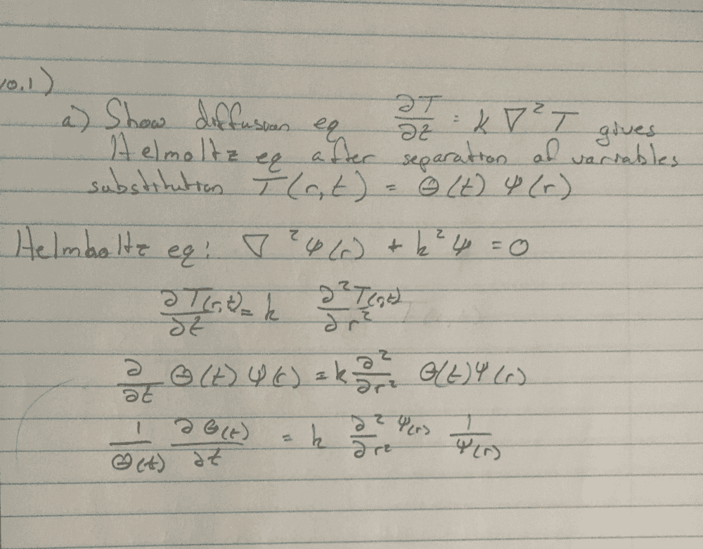

Question is shown below. Basically i am wondering if i am over thinking it or am i just plugging it in? I do not see where psi or theta are possible given to do any further work. Same would go for part b.
Helmholtz as defined in my text given below as well
Question:
Helmholtz as defined in text:
My attempt so far

So you conclude that each side of your last equation must be equal to some constant [itex]C[/itex], which means that [itex]\psi[/itex] satisfies...
And then you need to justify why [itex]C \leq 0[/itex].
(The constant [itex]k[/itex] which appears in the Helmholtz equation is not necessarily equal to the diffusivity [itex]\kappa[/itex] which appears in the diffusion equation. You need to clearly distinguish between these in your answer.)

Ok so that makes sense as that is how i have started similar problems in the pas that i had boundary conditions for.
I got Θ(t) = Θ(0)eCt and for the other ψ(r) = sin(ψC/[itex]\kappa[/itex]) + cos(ψC/[itex]\kappa[/itex])
Then i do the same for Helmholtz eq? OR
Do i set the C/[itex]\kappa[/itex] = [itex]k[/itex]? Then plug back in my general solution of ψ(r) and the second derivative of it to the Helmholtz eq hoping to yield 0? Showing that it is only true when [itex]C \leq 0[/itex] ?
No , i believe its not the easiest path to solve for ##\psi(\mathbf{r})## and then show that this ##\psi## satisfies Helmholtz. It is also wrong that you decide to replace the operator ##\nabla^2## with ##\frac{\partial^2}{\partial r^2}## cause we might be in 2 or 3 dimensions where the ##\nabla^2## operator has different expression. You have shown that $$\kappa\frac{\nabla^2\psi(\mathbf{r})}{\psi(\mathbf{r})}=C$$
From the above equation , how can you manipulate it algebraically to show that it is equivalent to Helmholtz equation ,I repeat again, without solving that equation for ##\psi##, just some algebraic manipulation is all that is needed and replacement of ##\frac{C}{\kappa}## with a proper constant so that we have the Helmholtz equation at the end of the algebraic manipulation.

So I am just a bit confused still. I need to solve the diff equation for ψ, then just manipulate it to look like Helmholtz?

I am not really getting anywhere. Do you have to be super vague on here? I feel like no one gives me direct answers haha. I just want to understand the problem
No you don't have to solve any equation for ##\psi## (I repeat myself for 3rd time and others have said this as well).
Just algebraic manipulation of this equation $$\kappa\frac{\nabla^2\psi(\mathbf{r})}{\psi(\mathbf{r})}=C$$ and you ll have Helmholtz equation.
Algebraic manipulation means for example that you ll transfer the denominator ##\psi(r)## on the right hand side, then you also may transfer ##\kappa## on the right hand side and then transfer all the right hand side to the left hand side so you ll have equation of "something"=0. That something will look like Helmholtz equation.

You can't solve the [itex]\psi[/itex] equation; you don't know what the boundary is or what condition you have to apply there.
You can solve the [itex]\theta[/itex] equation, which will tell you what values of [itex]C[/itex] are physically realistic (because you can rule out values of [itex]C[/itex] which lead to solutions which grow exponentially with time...).

I think this discussion overcomplicates things. You just make an separation ansatz
$$T(t,\vec{x})=\Theta(t) \psi(\vec{r})$$
as in the text shown in the scan in #1. Plugging this into the diffusion equation then leads to the Helmholtz equation for ##\psi(\vec{r})## by just defining ##k## in the right way.
