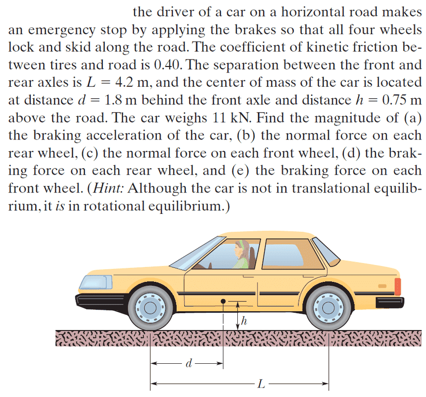

I get the correct answer if I use the COM as the axis of rotation for torque calculations. Shouldn't I be able to use any point as the axis of rotation for torque calculations, e.g. where the front wheels make contact with the ground?
Likes Delta2
Newton’s 2nd law applies to acceleration of the center of mass of the system. Even though there is no rotational acceleration, you must sum torques about the COM.
There is a way around this by using the concept of inertial forces, called pseudo forces. Since F=ma, rewrite it as F - ma = 0, where the quantity ma is the pseudo force. So apply the pseudo force ma at the COM , in the direction opposite the acceleration. Now you have an equilibrium situation since all forces and pseudo forces sum to zero, and you can thus sum torques about any point equal to 0 to get the answer.
I don’t often recommend the use of pseudo forces, although it works well here.
Likes Lnewqban
It is not a statics problem: the car is accelerating. You can use the COM or any fixed point in an inertial frame; otherwise you must include pseudo forces as @PhanthomJay describes.
This is very helpful, thank you so much!
Yes, that does clear things up--thank you!
why is that so? What makes valid the choice of COM for torque calculations in this problem?
I know that if two points positions vectors differ by ##\vec{d}## then the torques around those points differ by ##\vec{d}\times \sum \vec{F}## so if the sum of forces is not zero, then the total torque depends on the point chosen. I just don't understand why choosing COM (or any fixed point in an inertial frame) works for problems like this.
Because the problem is the linear acceleration of the body, and the pseudoforce representing that has no moment about the CoM.
