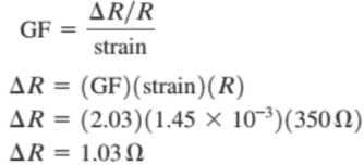

I do not understand this last part:
Is this needed? The divide by two is the voltage divider, correct?
I guess that's why I don't understand whoever wrote this.scottdave said:first figured
Our professor gave us a solution since the assignment isn't collected. (Among the 50 or so problems, I haven't found errors--but some of the problems are not from our book, and several solution's equations are not in the book or lecture.)scottdave said:Where did you get these formulas? Do you have the circuit diagram.
