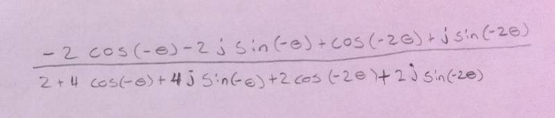

So I am a little rusty on my basic math and I am trying to simplify this expression. In case you were curious the expression came from a signal block diagram that I calculated the transfer function H(z) to then found the frequency response H(f) and I think i have done that correctly I just need to reduce this further. I have attached a picture of what I have left. The theta stands for exp(j2pifT) if that maters to you.
So this is where I get confused and can't remember the proper rules. These are super basic I know. Unfortunately I never learned them that well to begin with which is why I am having trouble now..
the terms that are j*sin(-2*theta) can I bring the -2 out of the sin function? Same with the cosine? I want to say no but part of me feels like you can... If so I am thinking this might help me cross out a few terms?
Or if i break it up into sections i get something like this for the first few terms. -2/4 * cos(-theta)/cos(-theta). I then feel like i can cross out the cosine terms and be left with -1/2? Same with the -2jsin(theta)/4jsin(theta) etc.
Am I going about this correctly? Some of it just doesn't seem right to me.

I don't see an attachment. There are formulas that tell you how to evaluate sin(2x) and cos(2x). If you remember the formulas for sin(x+y) and cos(x+y), you can use them with y=x. Also, keep in mind that sin is an odd function, and cos is an even function.
Sorry about that i had a link to the picture but it must be just me that can see it because it was local or something like that. I've uploaded it to a flikr type account and changed the link. You should be able to see it now.
I saw some of these forumulas but I am not 100% I am still looking at them as we speak.
I can see it now. You can certainly use the formulas I mentioned, but my first thought is that it doesn't look like the result will be any simpler.
Hmm maybe that's it then. The reason I said I want 100% was because I did try those formulas and it did not make the eq more simple so I suspected that I was doing something wrong. If it looks in simplest form to you then maybe that's the case.
Thanks for taking a look at this for me.
You should at least use the fact that sin is odd and cos even to get rid of the minus signs in front of the θ and 2θ.
I had another look at this, and I think the formulas I mentioned can simplify this a little. The expression cos θ-j sin θ shows up in a couple of places. Is j2=-1? In that case, cos θ-j sin θ=e-jθ.
The final result I got has 4(cos θ+1) as the denominator (after cancelling a factor of) e-jθ), and the numerator is at least a little bit simpler than what you started with.

I pretty sure that Evo8 meant to say that [itex]θ=2πfT[/itex], given the pattern of cos+j.sin combinations.
[itex]\frac{-2cos(-θ)-2j.sin(-θ)+cos(-2θ)+j.sin(-2θ)}{2+4cos(-θ)+4j.sin(-θ)+2cos(-2θ)+2j.sin(-2θ)}[/itex]
[itex]\ldots = \frac{-2e^{-jθ}+e^{-j2θ}}{2+4e^{-jθ}+2e^{-j2θ}}[/itex]
[itex]\ldots = \frac{e^{-jθ}(e^{-jθ}-2)}{2(e^{-jθ}+1)^{2}}[/itex]
Hmm, things behave badly when [itex]θ=π[/itex], or using my assumed identity above when [itex]2fT=1[/itex]
Well for starters my transfer function was derived wrong...:( I derived it from a block diagram and now realize the mistake. So this is irrelivent but at least i get some more experience with this.
