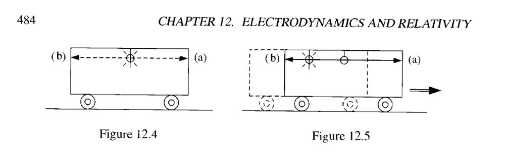

The lamp is equidistant from the two ends. When the light is switched on an observer on the train sees how both light rays hit the back and the front of the train simultaneously. This is not the case for an observer on the ground, who claims that the light ray going to the left hits the back before the light ray going to the right hits the front.
I am OK with this but I want now to focus on the simultaneity of the fire of both light rays. From the train's frame, both rays leave the lamp at the same time, one going to the right and the other to the left. My question now is:
Do they leave the bulb simultaneously from the ground's frame as they do wrt train's frame?
I'd say that the rays do leave at the same time as well, and this is my reasoning:

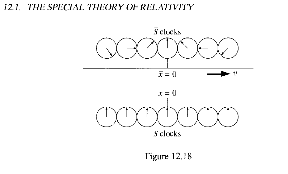

Let me be on the ground's frame and examine all the clocks in the train. I will realize that the clocks read different times depending upon their location because:
$$\bar t = -\gamma \frac{v}{c^2}x$$
Where ##\bar t## is the time elapsed in the train (according to the clocks in the train read by me, an observer located at the ground's frame). This is an illustration:
My point is that the master clock reads ##\bar t = 0##, so ##\bar t = 0 = t## which means that both light rays leave also at time zero (and thus simultaneously) from the ground's frame.
What do you think of my reasoning?
Yes. The two light rays being emitted from the bulb happens (roughly) at a single point in spacetime. There is never any disagreement about the number of events between frames.
Then the coordinates of the event are (0, 0, 0, 0) in both frames.
The light pulses leaving the bulb are not different events, it is a single event. Every event is simultaneous with itself regardless of the frame.

JD_PM said:
Why not?
Because they happen at the same place and the same time. That is the definition of a single event.
Likes JD_PM
JD_PM said:
Why not?
Do not be fooled by the nomenclature "event". In relativity it is a technical term referring to a given place at a given time. If the light signals are sent from the same place at the same time then they are by definition emitted from the same event.
Likes Dale and JD_PM
